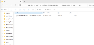

I am using S32K344 MCU and want to use HSE in it.
I have downloaded the HSE Fw executable from nxp flexnet.
and on extracting the exe file i get the hse pink file.
But am not able to get, how should i dump this binary to S32K344 MCU??
Is their need of some external debugger like lauterback or something for flashing the binary pink file? or i read their is HSE_Demo_app also, through which we can program the HSE firmware. If yes from where can we get HSE Demo App for S32K344 MCU??

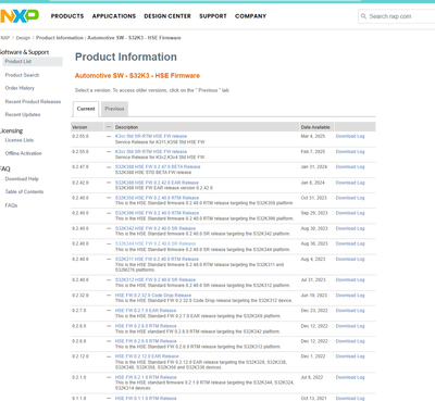

VaneB
Hi @Kunal_Gettobyte
The HSE DEMO APP can be downloaded from the S32K3 Standard Software → Automotive SW - S32K3 - HSE Firmware → S32K358 HSE FW 0.2.40.0 RTM Release. Additionally, the S32K3 MCUs for General Purpose HSE Demo Examples are available on the S32K3 devices page (S32K3 Microcontrollers for Automotive General Purpose) under Design Resources → Software. Release notes are provided with the software and can be found in the downloaded file.
Regarding the RTD version, neither the HSE DEMO APP nor the S32K3 MCUs for General Purpose HSE Demo Examples were developed using RTDs, nor is an RTD required for their operation.
