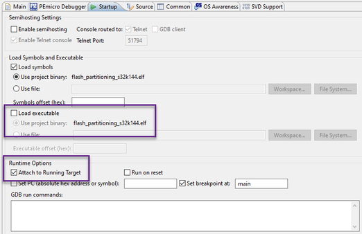

   My client wants to check the firmware bug using Hotsync S32K146 with s32ds3.4,how to setting ,thanks

Hi @teddywang,
What debugger do they use?
The PE Micro has this option to Attach the debugger to the running MCU:
BR, Daniel
