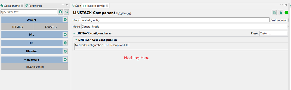

Hello!
The software I use is S32DS V3.5+S32K144_SDK 4.0.1. When using the LIN component, I found that the LIN configuration interface is incomplete and there is no LDF file description interface. I hope to get help, thank you.Snipaste_2024-05-11_16-44-42.pngSnipaste_2024-05-11_16-45-15.png

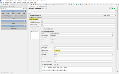

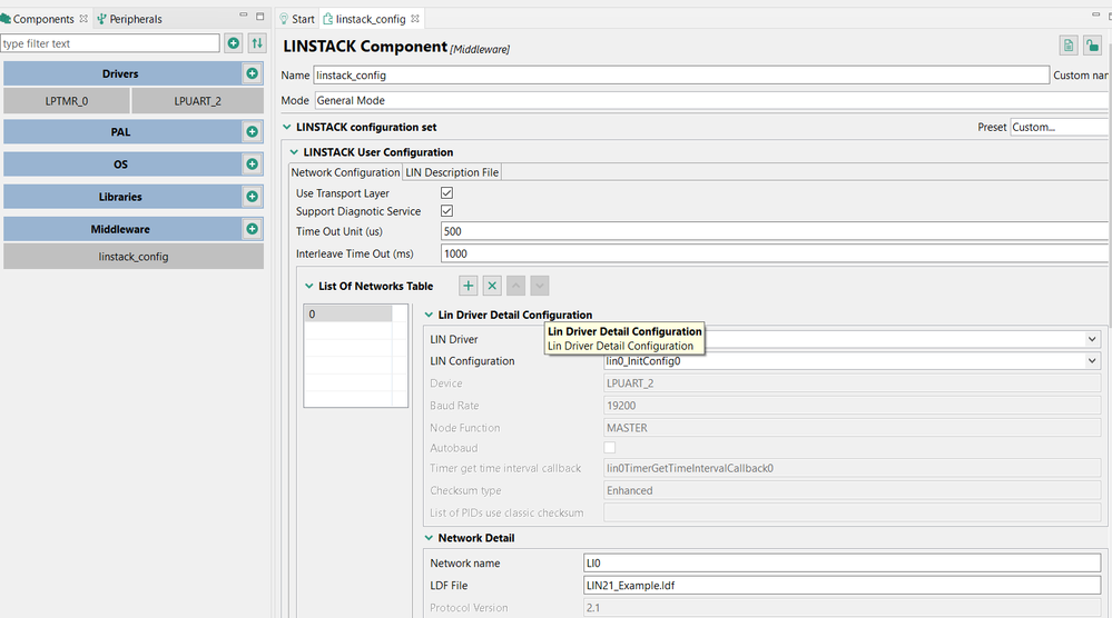

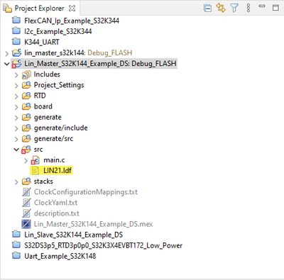

The LDF file is no longer reflected into the "LIN Description File" tab. You can load an existing LDF file into LIN stack component. The file should be copied into the project directory. Then LDF file is selected within "Network Configuration" tab.
The LDF file is automatically parsed, and its contents is reflected to LIN Slack component GUI. You can do modification of the parameters in the GUI's tabs and changes are automatically saved into the selected LDF file. The "Network Configuration" tab is where the file is reflected.
You can also use the Lin Stack package examples (as mentioned in this post: Solved: Re: LIN Middleware stack missing - NXP Community). Keep in mind that the latest package requires S32K1 RTD 2.0.0.
You can actually see in the latest release for the LIN stack, no file tab is available, only Network Configuration:
