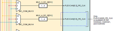

Hello.
I am leaving an inquiry because I have questions about the S32K3xx Clock-related documents.

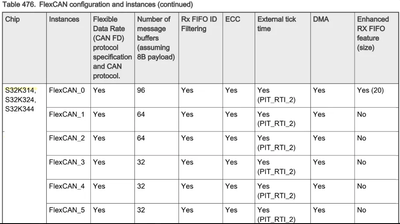

Looking at Figure 59. Other clocks and Table 476 FlexCAN configuration and instances, it says that S32K314 can use a total of 6 FlexCAN instances (FlexCAN0, 1, 2, 3, 4, 5, 6).
However, looking at Figure 65, FlexCAN[3]_PE_CLK can only use S32K322, S32K341, and S32K342.
So, is there a total of 5 PE clocks and 6 instances supplied to FlexCAN of S32K314?

a note on Fig65 says that from set of three PE clocks (FlexCAN[3:5]_PE_CLK) just a single one (FlexCAN[3]_PE_CLK) is available on S32K322, S32K341 and S32K342 devices. That is because S32K322, S32K341 and S32K342. includes four FlexCAN instances (0-3).
S32K344, S32K324, S32K314 includes six FlexCAN instances and so there are six PE clocks.
BR, Petr
