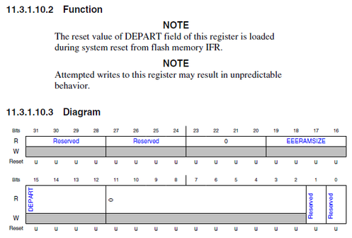

Could you read the SIM_FCFG1_DEPART register before the B SW tries to partition it?

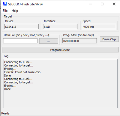

I don't know how you erase the A SW.
You can try the Unlock Kinetis command in J-link commander.

1. I am not sure what the input to read SIM_FCFG1_DEPART is.
I tried as below:
volatile uint32_t testReadRegister = SIM_FCFG1_DEPART(0x0F);
/* Calling flash command sequence function to execute the command */
ret = FLASH_DRV_CommandSequence(pSSDConfig);
And I got testReadRegister as 0xF000.
2. I erase SW A using "J-Flash Lite" using "Erase Chip" as below. Not sure what are exact steps involved
 3. Would you explain more about "You can try the Unlock Kinetis command in J-link commander." I am using S32K116 in S32 DS for ARM.

Hi Leila,
If DEPART reads 0xF, the partitioning has been removed by the Mass Erase and the MCU can be partitioned again, so I don't think there is a problem with the erasing.
If I understand, there is no problem with loading the B SW either but with the execution of the Program Partition command in B SW.
