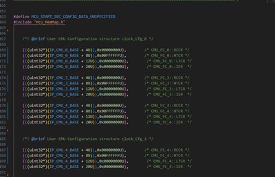

When performing a Code update on S32K324 RTD 4.0.0, CMU Clcok is not generated properly. What is the correct value?

This issue occurs when running UpdateCode in RTD (generates incorrect code)
When generating code, only the content is generated without variable names.
If I remember correctly, this issue has been unresolved for a long time. RTD3.0.0 also had the same issue.
Is there a fixed RTD version?

jwkang
After testing several times, the problem occurs. Have you tested it a lot?
I think it occurs when you enable Clock Register Values ​​Optimization.
And, I think the Index problem occurs when you create more than 2 Function groups of Clock.

Since I unfortunately do not have a board with a S32K324, I did an analysis of all the RTD versions available and I could identify that the patches for version 4.0.0 do not generate all the necessary code.
If you check the S32K3XX_memory_map file attached to the reference manual you will find that all S32K3 devices have CMU 0, CMU 3, CMU 4 and CMU 5; except the K388 which are the only ones that have CMU 6.
The changes to be made are:
Clock_Ip_Cfg_Defines.h
#define CLOCK_IP_REGISTER_VALUES_COUNT       (16U)
Clock_Ip_BOARD_InitPeripherals_PBcfg.c
const Clock_Ip_RegisterValueType Mcu_aClockRegisterValues[CLOCK_IP_REGISTER_VALUES_COUNT] = {
    /*! @brief User CMU Configuration structure clock_Cfg_0 */
    {((uint32*)(IP_CMU_0_BASE + 4U)),0x000000F0U},        /* CMU_FC_0::RCCR */
    {((uint32*)(IP_CMU_0_BASE + 8U)),0x00000058U},        /* CMU_FC_0::HTCR */
    {((uint32*)(IP_CMU_0_BASE + 12U)),0x0000004AU},        /* CMU_FC_0::LTCR */
    {((uint32*)(IP_CMU_0_BASE + 20U)),0x00000000U},        /* CMU_FC_0::IER  */
    {((uint32*)(IP_CMU_3_BASE + 4U)),0x0000006EU},        /* CMU_FC_3::RCCR */
    {((uint32*)(IP_CMU_3_BASE + 8U)),0x0000015EU},        /* CMU_FC_3::HTCR */
    {((uint32*)(IP_CMU_3_BASE + 12U)),0x00000139U},        /* CMU_FC_3::LTCR */
    {((uint32*)(IP_CMU_3_BASE + 20U)),0x00000000U},        /* CMU_FC_3::IER  */
    {((uint32*)(IP_CMU_4_BASE + 4U)),0x0000008CU},        /* CMU_FC_4::RCCR */
    {((uint32*)(IP_CMU_4_BASE + 8U)),0x00000097U},        /* CMU_FC_4::HTCR */
    {((uint32*)(IP_CMU_4_BASE + 12U)),0x00000084U},        /* CMU_FC_4::LTCR */
    {((uint32*)(IP_CMU_4_BASE + 20U)),0x00000000U},        /* CMU_FC_4::IER  */
    {((uint32*)(IP_CMU_5_BASE + 4U)),0x0000008CU},        /* CMU_FC_5::RCCR */
    {((uint32*)(IP_CMU_5_BASE + 8U)),0x00000097U},        /* CMU_FC_5::HTCR */
    {((uint32*)(IP_CMU_5_BASE + 12U)),0x00000084U},        /* CMU_FC_5::LTCR */
    {((uint32*)(IP_CMU_5_BASE + 20U)),0x00000000U},        /* CMU_FC_5::IER  */
I have not found anything else yet.
