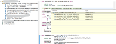

I created a project on S32K324 and a hardfault occurs during clock initialization.
I am using RTD4.0.0, D2403 and FreeRtos V10.6.0.
It seems that a hardfault occurs when loading reentry_guard_MCU_EXCLUSIVE_AREA_01.
What should I check?
