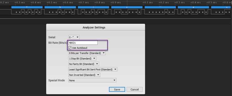

santhosh23
Hello @danielmartynek,
Yes, it is welcomeMsg and I even checked with baudrate which is 9600. I could see the message welcomeMsg on analyzer properly if I use the example uart_pal_echo_s32k116 individually. I am not sure where I am going wrong, do you see the same message on your analyzer too which is shown in below image?
Thanks & regards,
Santhosh

danielmartynek
Hi @santhosh23,
I just tested your project, I see the welcome message when I select Autobaud in my logic analyzer.
There must be something with the clock configuration.
Can test it on you side?

santhosh23
Hello @danielmartynek ,
Yes, you were right!
I've changed some clock configurations and now it is working as expected.

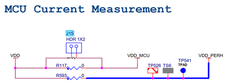

Currently, I am facing some hardware related problem with the board. the MCU isn't getting powered on even if I placed the jumper J107 to 2-3 position, however it is turning on if I remove the jumper J15 from its poition 1-2. Do you have any idea how I can do hardware reset for the board or do you have any other suggestions regarding this issue?
Santhosh

danielmartynek
Hi Santhosh,
It does not make much sense, J15 connect the power supply to the MCU, and there should be also R117 in place unless it was removed by you.
Can you please measure the MCU power supply with an multimeter?
Is the MCU heating when powered?

santhosh23
Thanks for your response!
Yes, I did the measurement of MCU power supply with an multimeter and there is no power supply coming in unless I remove the the jumper j15 from its position. After removing the jumper j15 it is showing as 5V and also D1 red led is turned on.
It was working fine before, I have no idea why isn't it working now. Even I do not see MCU getting heated up when powered on.
Do you have any idea how to do hardware reset for the board or would it be the problem with the MCU?
Thanks & regards,
Santhosh

danielmartynek
Hello Santhosh,
Is the input of J15 shorted to the ground?
Maybe if you remove J15, the MCU is not shorted anymore.
And it gets power supply via a GPIO pin instead.
So, it appears that it is powered even though J15 is disconnected.

santhosh23
Thank you so much for your quick reply!
You were right, jumper J15 pin 2 is shorted with gnd. When I further followed j15 with schematics. I noticed that C143 capacitor is short cicuited and needs to be replaced.
