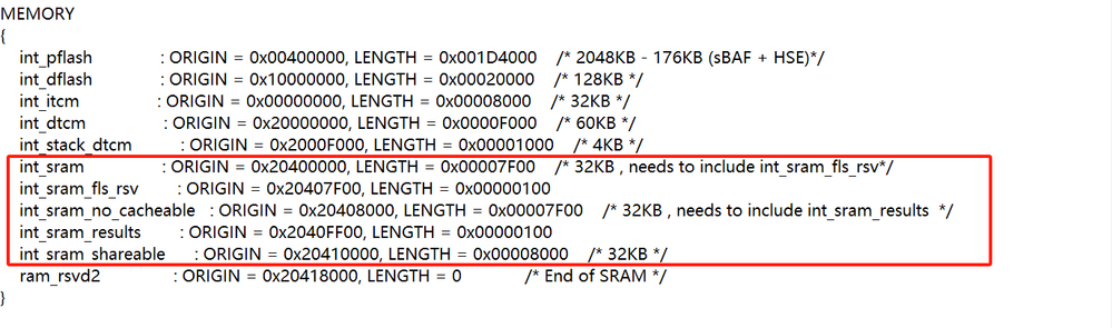

I'm using the S32DS 3.5 with the S32K312 chip.
I want to combine the three 32KB sram Spaces in the picture into one 96KB space. What should I do?

I would recommend to let all memory segment as they are, you can modify their length and start addresses according to your need. These segment are required by RTD drivers and other system purposes.
