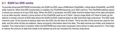

from mentioned application note:
In short, when you write to FlexRAM memory, new record is programmed to the FlexNVM. EEE controller is checking the content, once active block in FlexNVM is going to be full, it checks content of previous blocks, it programs still valid data to new block, so old block can be erased and new block can be set as active, etc...
Always write only aligned 16bit or 32bit word to FlexRAM. Anything else will generate more records than necessary.
The partition is supposed to be set only once during lifetime of a product. You would not be able to do that anyway because EraseAllBlocks command is needed to destroy the old partition and then you could set new one. But because you need to erase everything first, it's not an option.

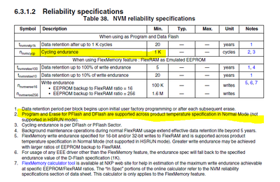

Now I have confused with D-flash write cycles- I have read in S32K datasheet and it showing 1K cycles maximum.
Does it true we can only write 1K maximum cycles in D-flash??

yes, there's 1K cycles only. Notice that there's also a difference if the flash is programmed directly by user or if EEE is used. The reason is that EEE use slightly different programming algorithm which is capable to perform more cycles. This is hidden to user and it cannot be used by user. So, if EEE is used then overall number of cycles is higher.

How come we can achieve high endurance with emulated eeprom ??
The back up is 64K bytes for 4K bytes eeprom. So, will it divide 16 sectors and write every time in different sector (only 4k sector)??
Does 64K bytes reach maximum cycles at one point of time or only 4K bytes sector ??

lukaszadrapa
You can take a look at this application note to understand how Emulated EEPROM works:
https://www.nxp.com/docs/en/application-note/AN11983.pdf
The FlexNVM can be used either directly using normal program and erase operations or you can use Emulated EEPROM feature when you write your data to FlexRAM and EEE stores the records to FlexNVM automatically.
Emulated EEPROM is usually used for data which are changed frequently/periodically. If you have a group of data which are changed frequently and group of data which are changed rarely, the best option is to separate them. You can put first group to EEE, second group to normal program flash. This can save some cycles due to nature of EEE algorithm.
