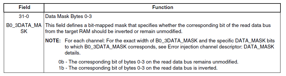

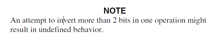

Hi! Some issues here:
I don't get why you are inverting ALL bits of the data when the RM states that:
and according to the manual,
B.R.
