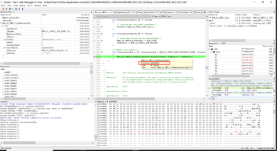

During debugging on S32K324 with RTD, I observed that the application always enters HardFault at the following assignment:
Mem_43_INFLS_eJobRuntimeInfo[InstanceIndex].JobResult = JobResult;
Debugger observation:
  • Variable Mem_43_INFLS_eJobRuntimeInfo is located at 0x20440000 (size: 40 bytes).
  • Faulting instruction:
    str r0, [r3, #32]
  • Exception registers:
    • CFSR = 0x00000400 (IMPRECISERR = 1)
    • HFSR = 0x40000000 (FORCED = 1)
    • BFARVALID = 0
    • BFAR = 0x00000000
This phenomenon is reproducible every time the above line executes.

Hi @Changyuke,
I'm sorry for the delay, I was out of office for a few days.
ldr r3, [pc, #12]
str r0, [r3, #32]
This code first reads a 32-bit value from the memory address at PC + 12 and loads it into register R3. This value typically represents a pointer to a data structure or memory region.

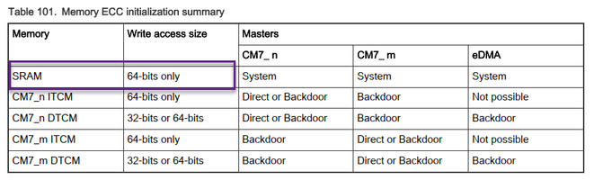

Next, a direct store instruction writes the contents of R0 to the memory address calculated as R3 + 32, which in this case resolves to 0x20440020.
Since the fault is not caused by MPU or XRDC configuration, it is likely due to the SRAM at that location not being properly initialized. The initialization must be performed using 64-bit aligned writes, not 32-bit writes. Attempting a 32-bit write to such a region that is not initialized will trigger an imprecise bus fault.
At the beginning of main(), you could initialize the memory:
    volatile uint64* ptr = (uint64*)0x20440000;
    *ptr = 0ULL;  // Write 64-bit zero
In disassembly, you should see STRD instruction.
Can the project then update Mem_43_INFLS_eJobRuntimeInfo?

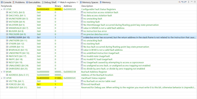

Thanks for the suggestions. I have checked the fault status registers, and here are the results:
  • CFSR = 0x00000400
    • IMPRECISERR = 1
    • PRECISERR = 0
    • BFARVALID = 0
  • BFAR = 0x00000000
I also:
  1. Disabled the MPU (removed MPU_ENABLE from the preprocessor).
  2. Configured the system clock strictly according to the options listed in the RM (Option B core clk @120Mhz), but the system still enters HardFault.
  3. I am not fully sure how to capture the exact fault instruction from the stack – could you please clarify how to do this in practice?
Do you have any further suggestions on how I can narrow down the root cause?

I checked the fault status registers during the HardFault:
  • CFSR = 0x00000400 (PRECISERR, precise data bus error)
  • HFSR = 0x40000000 (FORCED)
  • MMFAR = 0
  • BFAR = 0
For context: before integrating the FEE module, the program runs normally without any HardFault. The fault only occurs after configuring and integrating FEE according to the demo, suggesting the issue is related to the FEE initialization sequence.
