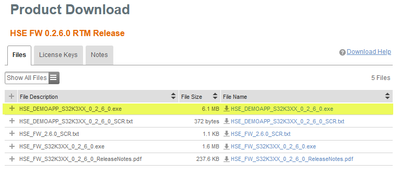

The firmware is provided in encrypted form as a binary file. Yes, HSE FW installation package contains only the binary (pink) file and corresponding API headers.
For Lauterbach users, there's also HSE DEMOAPP which helps to install the firmware and examine HSE features:
But notice that the demo works with Lauterbach debugger only. It won't work with Pemicro.

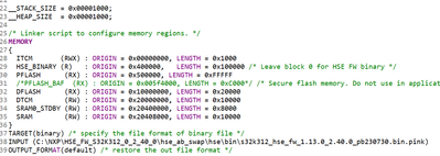

You can create new application project directly for S32K312 in S32 Design Studio. Then copy the source files from S32K344_HSE_FW_INSTALL, update HseFwHeader_StartAddress in boot_header.c. Then modify the linker file - use linker file from S32K344_HSE_FW_INSTALL as a template. If you read the readme.md file as I suggested earlier, there must be a link to the bin/pink file, so it is linked to the project.

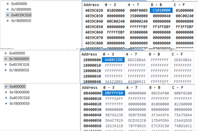

You can check bit 0 in HSE GPR status register at 0x4039C028. If it is '1', it means that "HSE FW is present and SBAF Booted HSE Firmware".

i can see the value 0xC1010000 at 0x4039C028 address.

I don't think the HSE GPR is defined in peripheral structure, so it's necessary to check the memory directly. If you can see 0xC1010000 at 0x4039C028, the HSE FW is obviously not installed.
Is the HSE feature flash at 0x1B000000 programmed?
And one more thing - I can remember that that if you use "without IVT" method to install the firmware, there can't be valid IVT in the flash. Otherwise it does not work. If you loaded the pink/bin file together with some project, it's necessary to remove the IVT. Or "with IVT" method must be used.

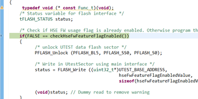

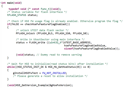

     I am just following the example code given for the s32k344, so i created same project for the s32k312 and imported the binary from the linker file, i see the 0xAABBCCDD  at 0x1B000000 location in memory window, what can be the problem. Every thing is same as per the example code as s32k344, only i changed the memory location in linker file. Can you please help on urgent basis, or can we connect online for debugging purpose on small call.
please find the snippet of the linker file and program.

          kindly check the image attached, the header of the AB_Swap is also there in the memory so it means the firmware is flashed in the memory, the utest area has value AABBCCDDDDCCBBAA it means utest is enabled, the HSE GPR register bit 0 is not getting set, i dont know why? it means after reset the SBAF is not installing the hse firmware in secure memory region.
kindly help on urgent basis.

Small problem on my side - I found that I already have firmware 2.6.0 on both my boards and it can't be erased (this feature was added in version 2.40.0). I will get brand new board on Monday and I will test it.
I checked the project anyway and I can see nothing wrong. I would just not program the HSE feature flag unconditionally after each reset.
