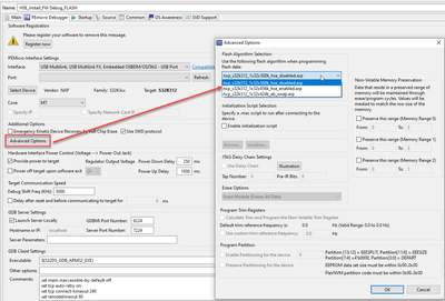

lukaszadrapa
I used another brand new board for my test and I used exactly the same project I sent you earlier. I loaded the project by S32DS via in-built Pemicro OpenSDA interface, run the project, power cycled the board 2x and then I can see that the bit in HSE GPR is set and FW is installed.
Once the HSE FW is installed, it's necessary to change the flash algorithm in Pemicro settings:
That's because some parts of flash are allocated for HSE when the HSE feature flag is enabled or when AB swap FW is installed. Pemicro needs to be informed about this.
3,168 Views

I had brand new chip, so I used default hse_disabled version. If HSE feature flash is already enabled but HSE FW is not installed yet, you should use hse_enabled. And once AB swap is installed, you should use ab_swap. But I don't think this could be wrong because Pemicro should show some error if it can't erase or program the flash. Even if you use hse_disabled when HSE feature flag is programmed, it will probably still work.
