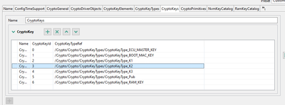

I got HSE_SRV_RSP_OK for Crypto_CalculatedM1M2M3(). but while calling Crypto_KeyElementSet(ECU_MASTER_KEY_ID, SHE_KEY_MATERIAL_ELEMENT_ID, KeyPram, SHE_M1M2M3_SIZE) I am getting HSE_SRV_RSP_KEY_INVALID.
ECU_MASTER_KEY_ID = 0
SHE_KEY_MATERIAL_ELEMENT_ID = 1
I have set HSE flag as VERIFY.
What could be the reason? Can you please guide me?
13,316 次查看
lukaszadrapa
ECU_MASTER_KEY_ID is defined as 1 in the SHE spec. Isn't this the problem?
13,312 次查看
shravani
@lukaszadrapa ,
I tried with 1 as well but no change in results. Please check below configuration.
13,295 次查看
lukaszadrapa

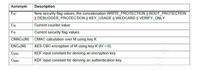

What attributes should we set while loading SHE key to secure NVM. In the RM758221-HSE-B Firmware Reference Manual - V2.1(2.1).pdf it is mentioned as below.
 However, In the configurator I cannot see the WILDCARD and KEY_USAGE flag.
Can you please guide me on this?
标记 (1)
13,068 次查看
lukaszadrapa
You can set required flags when calculating M1-M3 values. The function is:
void Crypto_CalculatedM1M2M3(CONST(uint8, AUTOMATIC) authKey[16], uint8 authKeyId, uint8 keyId, CONST(uint8, AUTOMATIC) key[16], uint32 counter, CONST(uint8, AUTOMATIC) uid[15], uint8 flags, VAR(uint8, AUTOMATIC) KeyPram[64])
Parameter 'uint8 flags' should be used. The order of bits is:
For example, if you want to set VERIFY_ONLY, the 'flags' should be 0x01.
There are no general rules which flags should be set, it depends on your requirements and on your application.

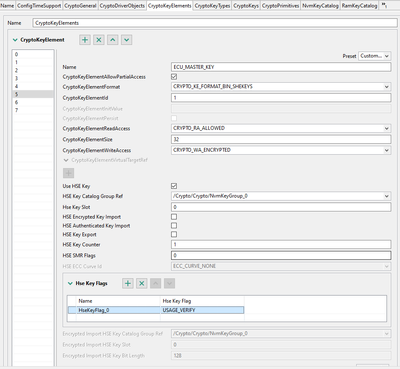

I am getting HSE_SRV_RSP_KEY_INVALID while caling RetVal = Crypto_KeyElementSet(ECU_MASTER_KEY_ID, SHE_KEY_MATERIAL_ELEMENT_ID, KeyPram, 64)
for this error it says in SHE, the key ID provided is either invalid or non-usable due to some flag restrictions. */
I am following example which you shared Crypto_CalculatedM1M2M3 and giving the flag value as 0 and configured the value as VERIFY ONLY from the configurator for the key. I tried by changing these 0 values to 1 for but still error is same.
P.S. I am able to load the key in plain format. But when encryption is applied, error is coming.
12,946 次查看
lukaszadrapa

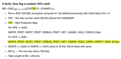

And next thing - CSEc on S32K1 has either 5 or 6 attribute key flags. SHE define 5 flags and there could be one more flag enabled (VERIFY_ONLY). HSE always expects 6 flags. But I can see that the code expects 5 flags only:
aM2Plain[3] |= (flags & 0x1e) >> 1U;
aM2Plain[4] |= (flags & 0x01) << 7U;
You can update it to this:
aM2Plain[3] |= (flags & 0x3c) >> 2U;
aM2Plain[4] |= (flags & 0x03) << 6U;
To understand where it goes - there's 28bit counter in M2 value and then the flags...
But if you used flags=0, I don't think this will make a difference.

shravani
@lukaszadrapa
I am able to load keys to secure NVM by adding key data in non-cacheable memory.
标记 (1)
