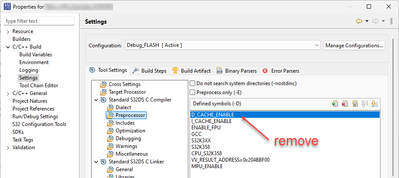

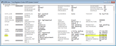

This sounds like data cache issue. All the data objects used for communication with HSE must be forced to non-cacheable memory. The data cache is usually configured to copy-back mode and HSE can't see the data cache on core(s), so this may cause coherency issues. HSE always accesses physical addresses only.
For quick test, you can try to disable the data cache completely. Either in your project settings or in your debugger:

That solved the problem.
