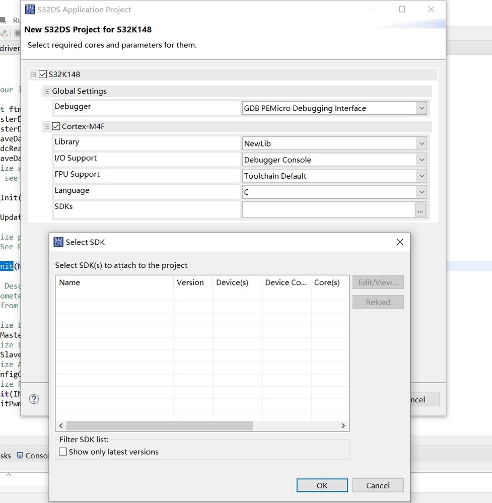

How can I use sdk for S32K148?Should I download the  files about SDK from the official website?
How can I download the S32 design studio for S32 platform 3.4 now?  I can not find this vision,I only can the vision of 3.6.

And as I explained above, there's no SDK for S32K1 for S32 Design Studio 3.6. And there won't be such SDK because it is already discontinued. It's replaced by RTD. Latest RTD 2.0.0 for S32K1 will work in S32DS 3.5. Next releases which are not available yet will be supported by S32DS 3.6.

SDK is an older software package which is not maintaned anymore. The latest version is 4.0.3 and this version is supported only by S32 Design Studio 3.4.
S32DS 3.4 can be downloaded here:
https://www.nxp.com/webapp/swlicensing/sso/downloadSoftware.sp?catid=S32DS-3-4
Select "S32 Design Studio IDE" in the list and then you should see version 3.4 to download.
To install SDK 4.0.3, start the S32 Design Studio, select Help -> S32DS Extensions and Updates. Search for the SDK in the list and install it.
The SDK is now replaced by RTD:
https://www.nxp.com/design/design-center/software/automotive-software-and-tools/real-time-drivers-rt...
There's Ip layer similar to SDK and then Autosar MCAL layer. All in this one package. It can be downloaded here:
https://www.nxp.com/webapp/swlicensing/sso/downloadSoftware.sp?catid=SW32K1-RTD44-D
Latest version is 2.0.0. Each SW package contains release notes pdf file. I recommend to always thoroughly read it. It specifies which S32 Design Studio and which update should be used exactly.

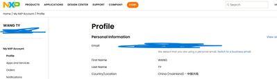

 Every time I click S32 DS 3.4,the web will go to my account.The web will not lead me to the files of download.And I can not find the software in the web of my account.
   Can you tell me how to find the web of download? Or ,How to select SDKs in my new project in S32 DS 3.6?every time I start a new project ,the option to select SDK is blank。

Let's try another way. Click on this link:
https://www.nxp.com/webapp/swlicensing/swlicensingIntermediate.sp
Select "Software accounts". Then click on the "NXP Software" in the list and then on "S32 Design Studio IDE".
This should bring you to this:
Is this working? If not, you can try different browser, maybe try to delete cookies... Not sure what's wrong on your side.
