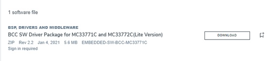

Hi@davorin_mista
I found some information for your reference.

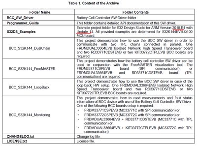

demo code:
https://www.nxp.com/design/analog-expert-software-and-tools/sdk-analog-expert-drivers/14-cell-batter...
There is a detailed description of the requirements in this download package, the compilation environment requires 2018.R1, FreeMaster should have no version restrictions,

davorin_mista
Thank you, very helpful.

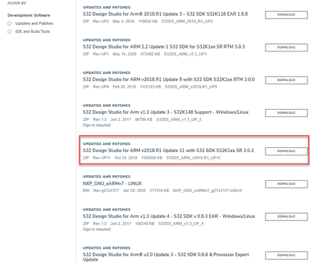

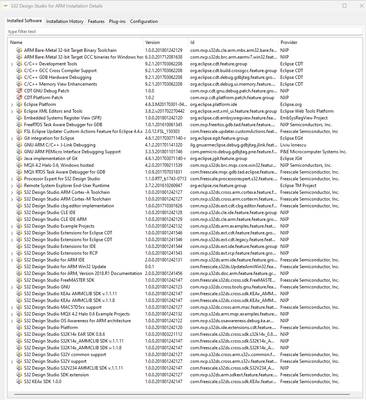

I do have 2018.R1 installed however I can't figure out how to get update 11. Here's what I have installed according to About - Installation Details:

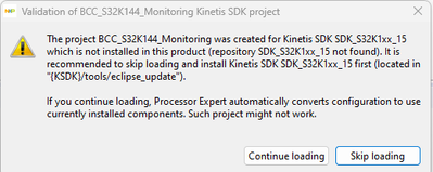

Also when I import the project I get this warning:
Shall I ignore this or do I need to get the Kinetis SDK?
Thanks!
Davorin

Senlent
Hi@davorin_mista
I find this SDK download address, you can try to intall it and built again,
https://www.nxp.com/design/software/development-software/s32-design-studio-ide/s32-design-studio-for...

davorin_mista

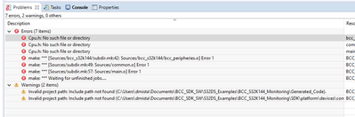

Thank you, I did install the Update11 as you suggested however when trying to build the Monitoring project I get compilation errors:

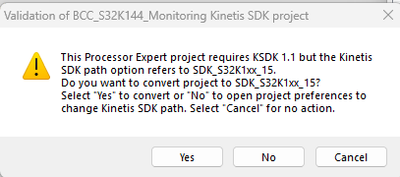

Also, not sure if it matters but after importing the project I first get a warning about the Kinetis version:
I chose "Yes" then the project finished importing without errors/warnings.
1,909件の閲覧回数
davorin_mista
Sorry, I was able to overcome this by starting from scratch, i.e. re-extracting the EMBEDDED-SW-BCC-MC33771C ZIP file - seems all good now!
