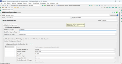

I am using the nxp s32k144 controller board. I need a 12.28 MHz PWM.
Initially I went from SDK example of FTM.
I have change the PWM frequency in FTM SDK example for Peripheral
My question are
1. what is the process to find out the generating PWM frequency? Can you provide one example to explain?
2. If I put 6.144Mhz in PWM Frequency of FTM PWM independent configuration (as mention in peripheral snap) then I got ~ 6.85 MHz frequency, If I put 12.28 MHz Frequency in PWM Frequency of FTM PWM independent configuration (as mention in peripheral snap) then I got 16 MHz at output side.
so what are the step to be fallow to generate a particular frequency with less tolerance limit?

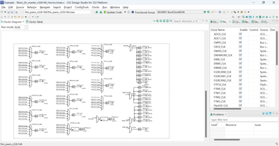

4. also check the clock diagram where I can be modified the factor so that I can get PWM of 12.28 MHz frequency

For PWM frequency of 12.28MHz with FTM clock frequency of 48MHz you need 3.9 ticks:
1s -> 48MHz (48,000,000 ticks)
12.28MHz = (1/12,280,000)s
->48,000,000 *(1/12,280,000) = 3.90 ticks
As you can see, setting a PWM frequency too high for FTM clock frequency leaves you with little resolution for duty cycle. Additionally, you cannot manage decimal numbers for ticks. What you can do is increase the clock frequency and set an appropriate frequency for integer ticks.
Hope it helps you.
