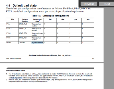

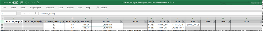

Hi Bhuvana,
PTA17 default DISABLED(High impedance). If you want to make it low before initialization, please add external pull-down mechanism.
Robin

Robin_Shen
All GPIO(except PTA4\PTA5\PTC4\PTC5) default Disabled High impedance.
The on-chip peripheral modules are disabled and the non-analog I/O pins are initially configured as disabled. The pins with analog functions assigned to them are configured for their analog functions after reset.
