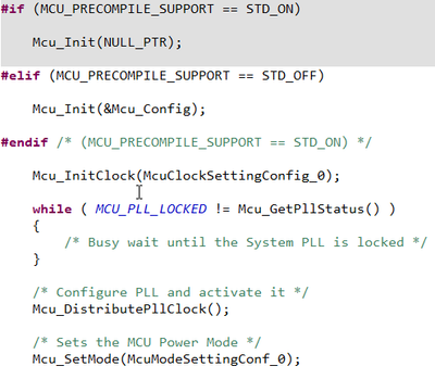

Hello @quangvuanh,
I had another project (without the sequence related to FS26) where the functional reset was working as expected, but there was a slight difference in the configurations.
In the MCU Driver, under the McuModeSettingConf tab and in the McuPeripheral tab, PLL was disabled.
I discussed some clock issues with @RadoslavB before, and the problem i had (which was a PIT interrupt not happening every X seconds, it happened at random times) was solved after enabling the PLL Clock under the McuPeripheral tab, and doing this initialization:
So, i guess the issue might be here. When the PLL Clock is enabled, the functional reset doesn't happen.
When it is disabled, the functional reset works as expected.
Are these two topics related to one another?

JRodrigues
Hello @quangvuanh ,
Another note on this test:
When PLL is enabled, and right after the reset, the program seems to be stuck inside the NMI Handler and maybe that's why it never restarts the program, because once the microcontroller begins the program, it automatically jumps to the NMI Handler due to faults being present in the FCCU that have the "Fault State NMI Enable" reaction type enabled.
Is there a way to fix this?

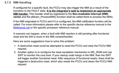

quangvuanh
Hi @JRodrigues , I found this information being mentioned in the User Manual of eMCEM module.
To overcome this issue, I think @RadoslavB could have more experience than me, please take a look and consider.

The reset happens, but when the program restarts it goes immediately to the NMI Handler (in both cases). At least that's what i could see when i attached Lauterbach right after the functional reset.
I do understand that, but wouldn't that go against the purpose of the Microcontroller Recovery Strategy described in FS26's documentation?
My idea, and what i discussed with @RadoslavB, was that once the program entered the NMI Handler, the FCCU_RST would trigger and the program would restart (in the main function), clear all faults when "eMcem_Init()" is called and then proceed to FS26's initialization.
Once this was over we would have achieved the 2 conditions to go back to normal mode (All faults cleared and a good watchdog refresh) and we would avoid resetting the microcontroller from the SBC side.
Am i thinking wrong here?

quangvuanh
Hi @JRodrigues
It does not go against the Recovery Strategy. If Mcu gets stuck in NMI Handler, means it failed to recover from faults, then FS26 acts as external observer to prevent your MCU from being stuck forever there. Vice versa, if Mcu recovers successfully and refresh wdg recovery timer of FS26, the application program goes back to its normal state.
