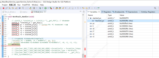

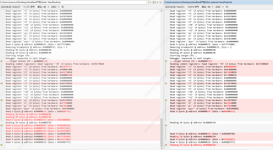

Dear NXP experts,
My Toolchain: S32DS v3.4, S32SDK_S32K1XX_STM_4.0.3, SEGGER J-Link GDB Server V7.98a;
MCU:S32K142W;
Problem description:

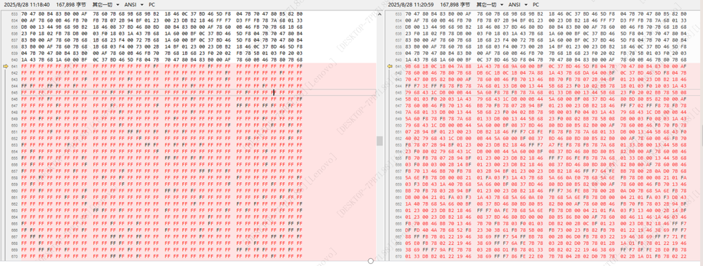

As shown in the figure above, move LedToggle() from line 678 to line 659, build it, debug it, and trigger a Hard fault when stepping on "FTM_DRV_InitInputCapture()" from line 286 in the figure below.

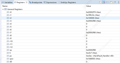

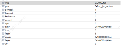

Key data obtained after triggering a Hard fault:
Let me add the process of restoring a Hard Fault:
The first method:
Use J-Flash V7.98a to erase the entire code of S32K142W chip, then enter S32DS V3.4 environment for debugging, and it will be restored to normal. This method has been tested repeatedly.
The second method:
Firstly, change Optimization Level: None (- O0) to Optimization Level: Optimize (- O1), debug again, and restore normal operation without entering Hard Fault again;
Then, based on keeping the code as it is, change the Optimization Level: Optimize (- O1) back to Optimization Level: None (- O0), debug again, run normally, and no longer enter Hard Fault;

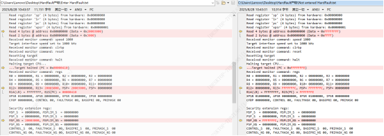

Finally, at Optimization Level: None (- O0), the difference between entering Hard Fault and not entering Hard Fault was compared between the two Build generated files. The conclusion was that there was no difference (as shown in the figure below), but the results of the two debug attempts were different.

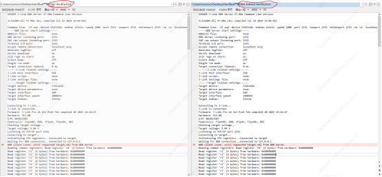

We compared the debugging information in the Console window between entering Hard Fault (left file) and not entering Hard Fault (right file) during these two debugs, as shown in the following figure:
Can you help me analyze why the Hard Fault was triggered?

Hi @danielmartynek
I have found the reason, it is a compatibility issue between S32DS v3.4 and Segger Jlink version. After upgrading to the latter version, the problem was resolved.

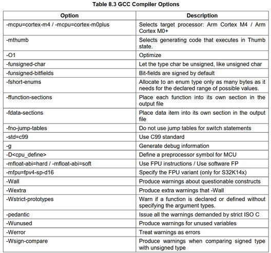

Please note that NXP guarantees the functionality of the SDK only when the compiler options are configured according to the SDK release notes. The SDK was developed and tested under those specific settings.
Could you adjust your compiler options to match the configuration outlined in the release notes?

Note:The options in blue font are consistent with the requirements of "S32 SDK Release Notes Version 4.0.3 RTM";
The option in black font is unique to me;

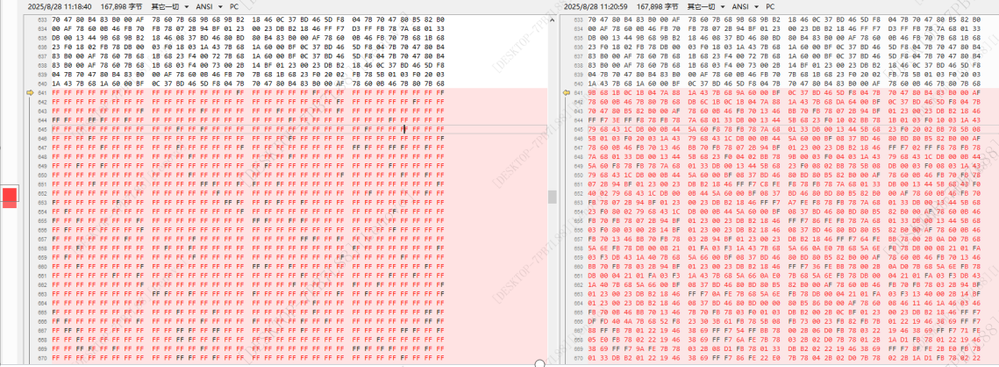

When my compilation options are the same as those provided in "S32 SDK Release Notes Version 4.0.3 RTM", there is still a situation of entering Hardfault, which has not been improved.
I have identified a key issue, which is that when a problem occurs, I use J-Flash V7.98a to read data from the chip's Flash and compare it with the Bin file generated by the project. I found that there is a section of content with a length of 248 bytes, all of which are 0xFF, which is different from the content of the Bin file.As shown in the figure below.
Why is there a section of code downloaded through Debug that is incorrect ?
LF

  • You programmed the binary using J-Flash V7.98a, but after programming, there is a 248-byte section in Flash that remains erased (filled with 0xFF), which does not match the content of the binary.

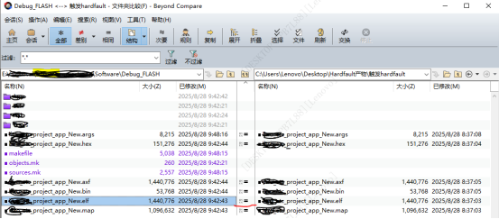

I will reorganize my operation process:
Step one,
In the S32DS V3.4 environment, delete a test code and then execute Clean ->Build ->Debug ->Resume. The program immediately freezes at HardFault_CHandler().
Next, stop Debug and exit the S32DS V3.4 environment. Using J-Flash V7.98a to connect to the target chip, only the operation of reading the program in the chip is performed. Comparing the read program with the content of the Bin file, it is found that 248 bytes of the program in the chip are filled with 0xFF, which is different from the program in the Bin file. Please refer to the following figure for details.
The second step,
Connect the target chip using J-Flash V7.98a, perform only the "Erase Chip" operation, and disconnect the connection.
Step three,
In S32DS V3.4 environment, execute Debug ->Resume to restore the program to normal.

danielmartynek
Hi @FAR1234,
Are the erased bytes located at 0x5000?
What is at this address in the linker file?
Do you write to the flash configuration field at 0x400?
Does the S32DS reports any issues when it programs the MCU incorrectly?
Can you share the log?

In response to your question, we would like to provide the following response:
1), Are the erased bytes located at 0x5000?
I am performing a full erase, specifically from 0000_0000 to 0003_FFFF, and from 1000_0000 to 1000_FFFF.
2), What is at this address in the linker file?
I didn't understand what you meant, but I provided my link file.
Please see what I added at the bottom: Content of file "S32K142W_32_flash.ld"
3), Do you write to the flash configuration field at 0x400?
I have never written the flash configuration field at 0x400.

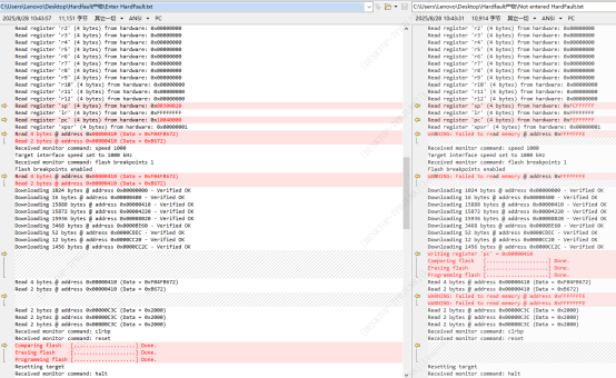

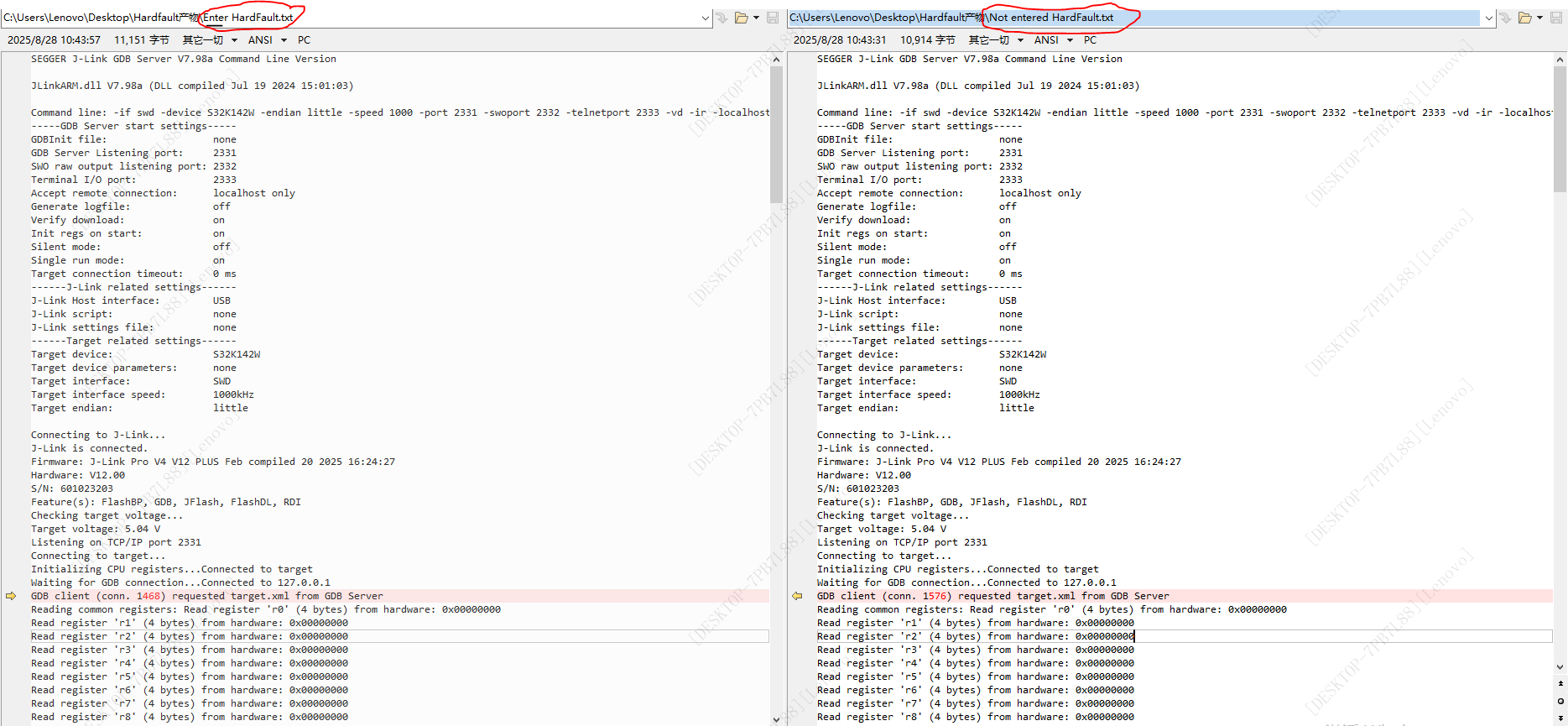

4), Does the S32DS reports any issues when it programs the MCU incorrectly?
I didn't notice any errors.
5), Can you share the log?
Please refer to the attachment (Hardfault pictures. rar), where "Image 5. png", "Image 6. png", "Image 7. png", and "Image 8. png" are related to log information.

Hi @FAR1234,
Q1. You showed a dump of some memory, what memory is it? What is the address of it?
Q2. Can you also show the .map file at the address range from Q1?
Q3. Can you read the bytes at 0x400 - 0x40F?
Thank you,
1,429 Views
FAR1234
Hi @danielmartynek
best regards
LF
