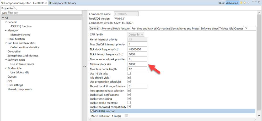

Hi Experts,
My project is OK without FreeRtos OS. When I add FreeRtos OS and add OSIF_MutexLock and OSIF_MutexUnlock in the file <Var_Manage.c> and <E_Buf_A.c>, I got some problems.
1、When start Scheduler, Can't enter the I2C interrupt----LPI2C_DRV_MasterIRQHandler, but Can enter the  I2C interrupt before starting Scheduler.
2、After a period of running time after Scheduler, the software will reset.
I don't know what is the root cause.
I don't know whether the FreeRtos OS configaration is OK.
I don't know the Mutex Using is OK or not.
I don't know the I2C drivers is OK or not(What attention after Using FreeRtos?)
Or anything else wrong?
Can anyone help me ? Can Experts check my project?
Thanks Very much.
I attach  my project.

One of the most usual reasons why the OSIF_MutexLock and OSIF_MutexUnlock doesn't work is that the heap or the task stack isn't enough so I will suggest incrementing these two memory sizes:
Let me know if this helps you.

Hi, Alexis,
IF I set the heap and stack as you pointed , the sw can run at all.

赵子成
Hi Alexis,
I don't understand why we need so much RAM?
You know the S32K144 have only 64K RAM, It seems no reason using a half to FreeRTOS.
