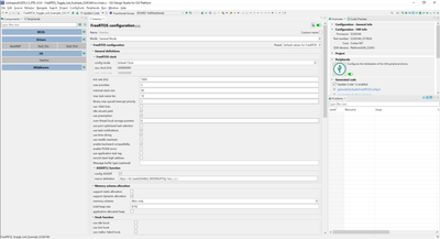

You can find the FreeRTOS package for S32K3 platforms as an extension by going into "S32K3 Auto General-Purpose MCUs' page > scrolling down to Software > S32K3 Reference Software > Automotive SW - S32K3 - FreeRTOS."
This package includes simple examples (FreeRTOS_Toggle_Led_Example_S32K344) as well as support for Config Tools inside Design Studio, which provides an easier configuration for the FreeRTOS driver:
You can also look into the BMS SW Installation Guide for a HVBMS Reference Application and the installation steps.
The HVBMS Reference Integration project showcases a possible implementation of the HVBMS-RD Initialization and DTTI (Diagnostic Test Time Intervals) sequence. Using FreeRTOS and a base cycle of 5 ms for Initialization, and 20 ms for the DTTI.
SafeRTOS is not NXP product and there is no plan to support this component. You can try to use this component directly (FreeRTOS and SafeRTOS are similar), but any driver included in the packages has not been tested with SafeRTOS (or with the idea to migrate to SafeRTOS eventually).
