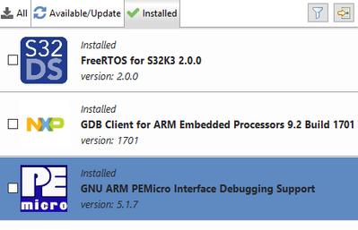

DanNguyenDuy
Hi @zjldabing,
I ran your example successfully on both PE and Trace 32 debugger.
I'm using PE 5.1.7 version.
Dan

zjldabing
Hi, Dan
Your result reminds me if there is configuration difference between our PE debugger.I tried a lot of the setting one by one and get one setting at last.That's "Attach to Running Target" in the filed of runtime options.It can run well and the tasks switch as expected after enable that option.
It is a stange setting as it overwrite the option "set breakpoint at main".The program directly running instead of stop at the front of main as I usually debug.I am sure if your PE debugger have this option setting enabled.
