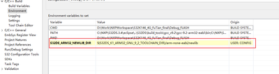

KILLERzheng
I solve this problem by adding the dir info below, for reference only.

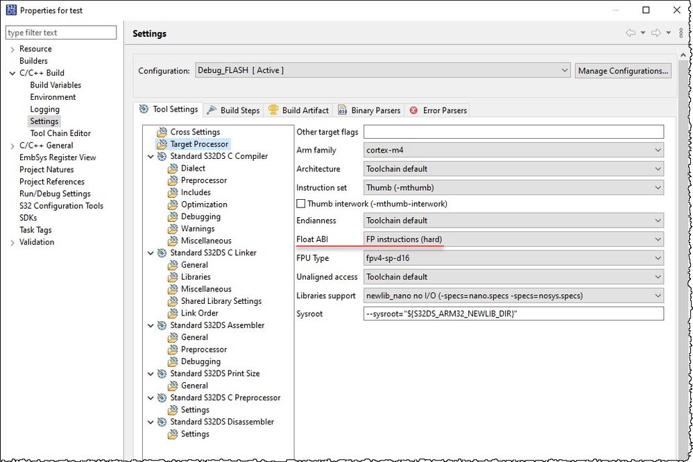

Robin_Shen
Did your project enable the hardware FPU?
ENABLE_FPU Float ABI FP instructions (hard).pngENABLE_FPU Float ABI FP instructions (hard).png
Robin

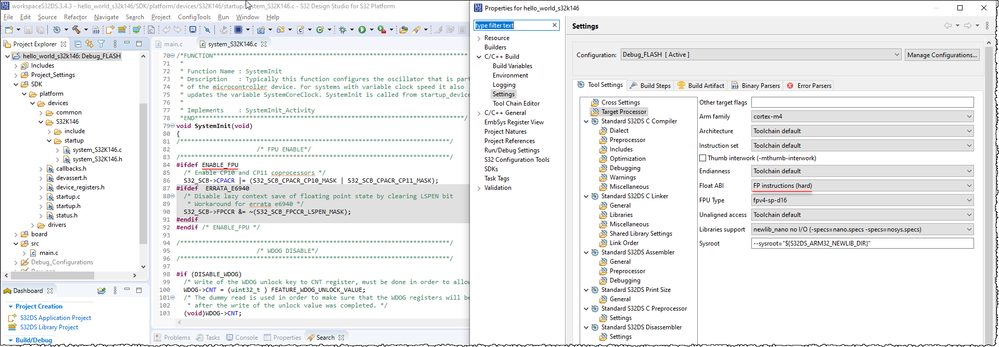

KelvinSmith
Thanks Robin,
I looked for a setting like that and couldn't find it. But there must still be some setting because now when I build, during the link I get errors like this for each file:
c:/nxp/s32ds.3.4/s32ds/build_tools/gcc_b1620/gcc-6.3-arm32-eabi/bin/../lib/gcc/arm-none-eabi/6.3.1/../../../../arm-none-eabi/bin/real-ld.exe: error: libuavcanV1_demo.elf uses VFP register arguments, ./Project_Settings/Startup_Code/system_S32K146.o does not
c:/nxp/s32ds.3.4/s32ds/build_tools/gcc_b1620/gcc-6.3-arm32-eabi/bin/../lib/gcc/arm-none-eabi/6.3.1/../../../../arm-none-eabi/bin/real-ld.exe: failed to merge target specific data of file ./Project_Settings/Startup_Code/system_S32K146.o

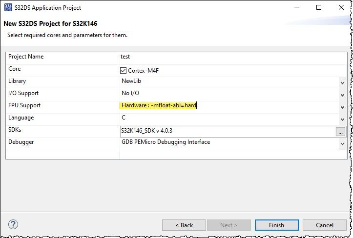

Robin_Shen
Sorry. I don't understand what do you mean: I looked for a setting like that and couldn't find it.
What IDE are you using? If you are using S32DS, then you can select Hardware FPU during create new S32DS Project too.
New S32DS Project.jpgNew S32DS Project.jpgFloat ABI.jpgFloat ABI.jpgvmul vdiv.jpgvmul vdiv.jpg

KelvinSmith
Robin, I see that what I said was ambiguous. I did find the option (as you described) and I selected it, matching the images above. But when I compile, at the link stage, I get the errors I listed above.
