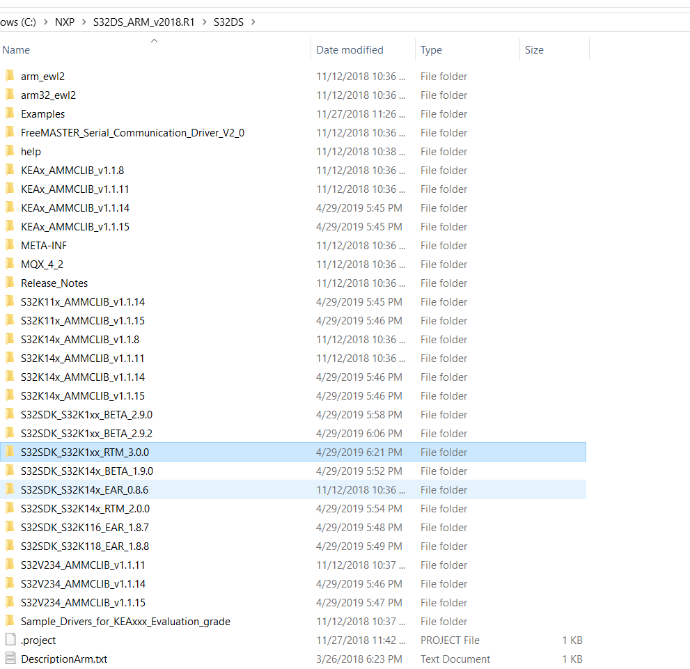

eason_chen
Hi Diana,
First at all, thank you for the support.
I use S32SDK_S32K116_EAR_1.8.7.
I download it on 4/29.
Is it the newest one?
If yes, the newest SDK can't solve this issue.
BR,
Eason
4,404 Views

eason_chen
Hi Diana,
Although I can't download RTM3.0.1 but RTM3.0.0 is downloaded complete.
And i tried RTM3.0.0, unfortunately this issue still exist.
BR,
Eason
4,404 Views
