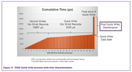

1. when I want to run quick write mode, maximum time for clean up is (#number of quick writes * 2) ms. is this true: "when we want to write 32 bytes, clean up time will be : (32/4)*2 = 16 ms at maximum" ?

1.
The elapse time is the same in both cases.
It is the Set FlexRAM Function execution time with control code 0x00.
DS rev.13, Table 35. Flash command timing specifications for S32K14x series

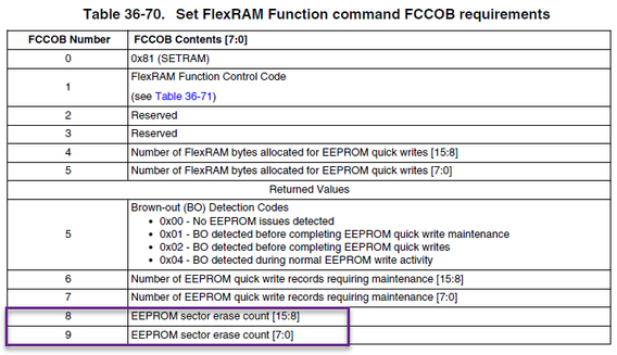

But you can use the SetFlexRAM function with control code 0x77 to get the Sector erase count.
The counter increments every time all the sectors erased are.

1.

1.
Yes
2.
It is explained in AN11983,
Chapter 6 S32K1xx new quick write mode
3.2.1.4 FlexRAM used for querying write status on EEPROM
3.2.1.5 FlexRAM used to complete interrupted EEPROM quick write process
