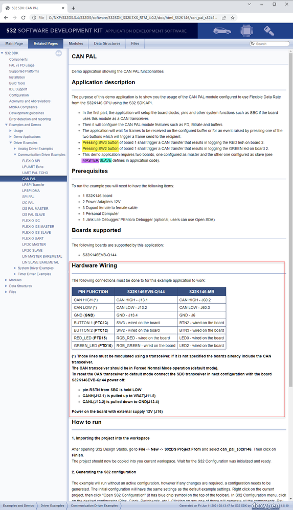

Assuming you are using can_pal_s32k146 example in S32K1xx SDK RTM v4.0.2 with S32K146EVB.
According the the description.txt, please open example documentation(CAL PAL notice the Application description and Hardware Wiring
CAN PAL RTM4.0.2 can_pal_s32k146.pngcan_pal_s32k146 MASTER SLAVE button.pngcan_pal_s32k146 Pins.png
Did you press SW2(PTC12) or SW3(PTC13) buttons?

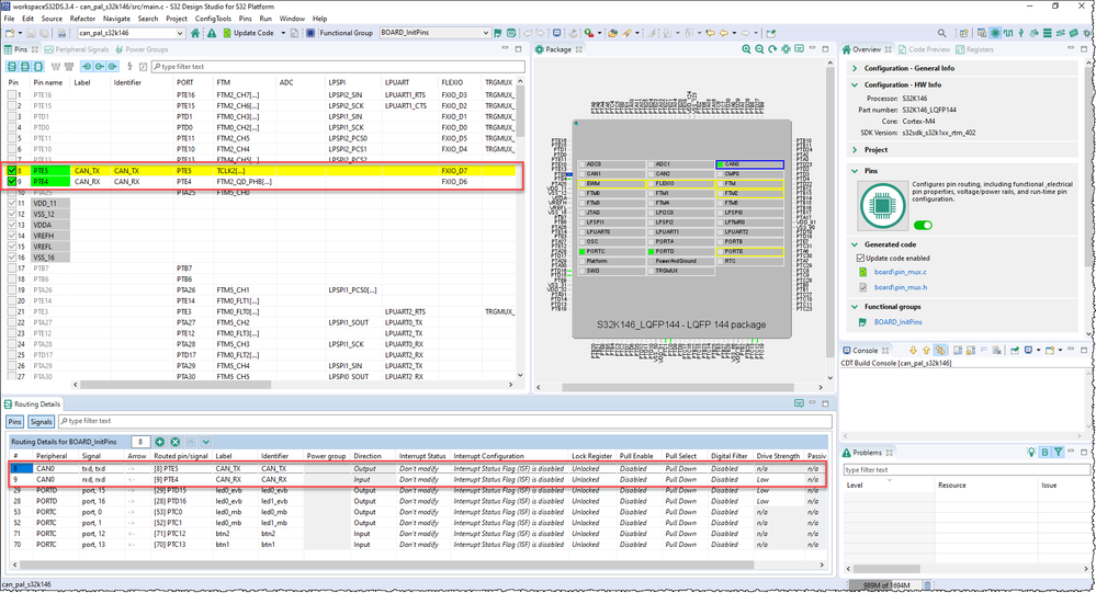

Would you please point out where is the CAN_1 Tx pin? That example select PTE5 as CAN0_TX.

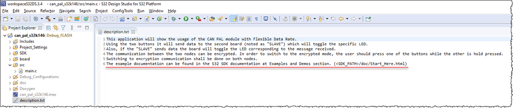

If you don't use the encrypted function, please test the can_pal example.
About the FlexCAN encrypted s32k146, please refer to file:///C:/NXP/S32DS.3.4/S32DS/software/S32SDK_S32K1XX_RTM_4.0.2/doc/html_S32K146/flexcan_encrypted_s32k146_group.html

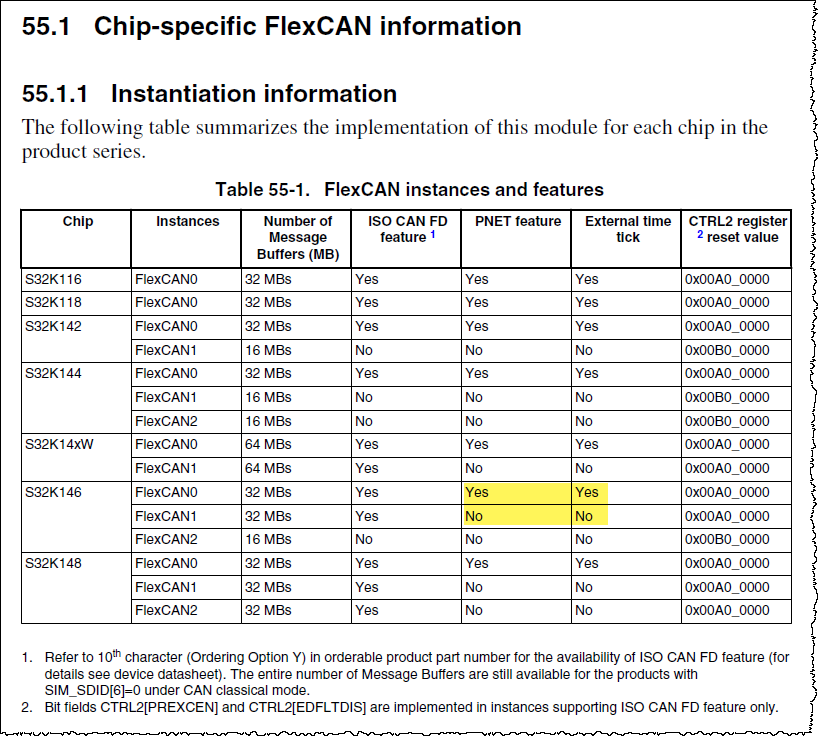

2. Added the PIN mux setting to CAN 1, PTE 12 and 13   PTA12 and PTA13?
Please refer to CAN1 not working in S32K144
Here is the difference:
16,251 Views
ArunkumarV
Hi Robin,
Thanks for your support, and both the CAN working fine.
Thanks for the Link.

Port is PTA 12 and 13 for CAN 1, not PTE. its my mistake.
Thanks for the link, will check and get back to you.
16,324 Views
ArunkumarV
Hi Robin,
Thanks for pointing the right configuration, it works well after changing the FD.
