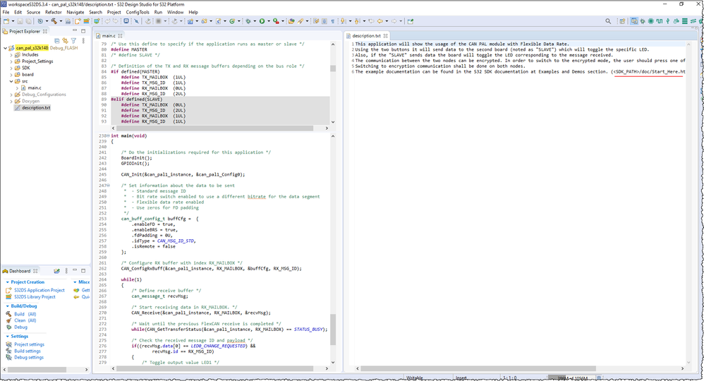

Hi Kallappa,

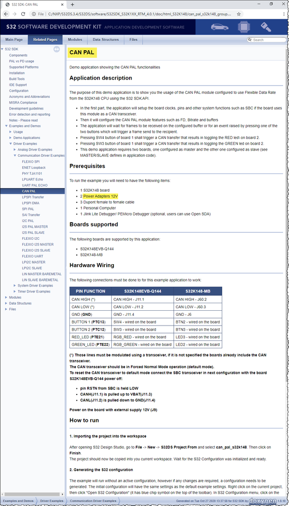

There are two FlexCAN examples in S32 SDK that you can refer: can_pal_s32k148 and flexcan_encrypted_s32k148
For example: Please read the documentation of can_pal_s32k148  first.
The example documentation can be found in the S32 SDK documentation at Examples and Demos section. (<SDK_PATH>/doc/Start_Here.html)

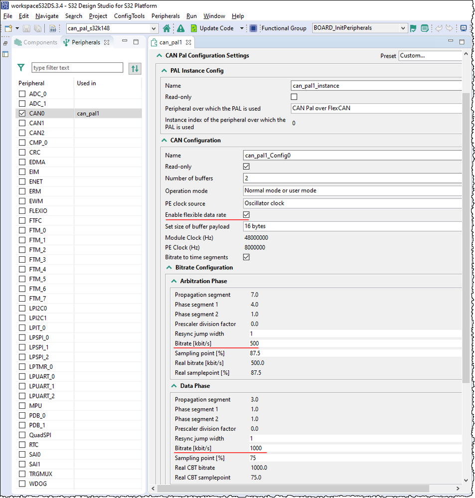

Then configure the PCAN-Pro according to the FlexCAN configuration:
CAN                      FD
Arbitration Phase  500Kbps
Data Phase          1000Kbps
After press SW3 and SW4, the PCAN-Pro will show the CAN message sent from S32K148EVB board 1.

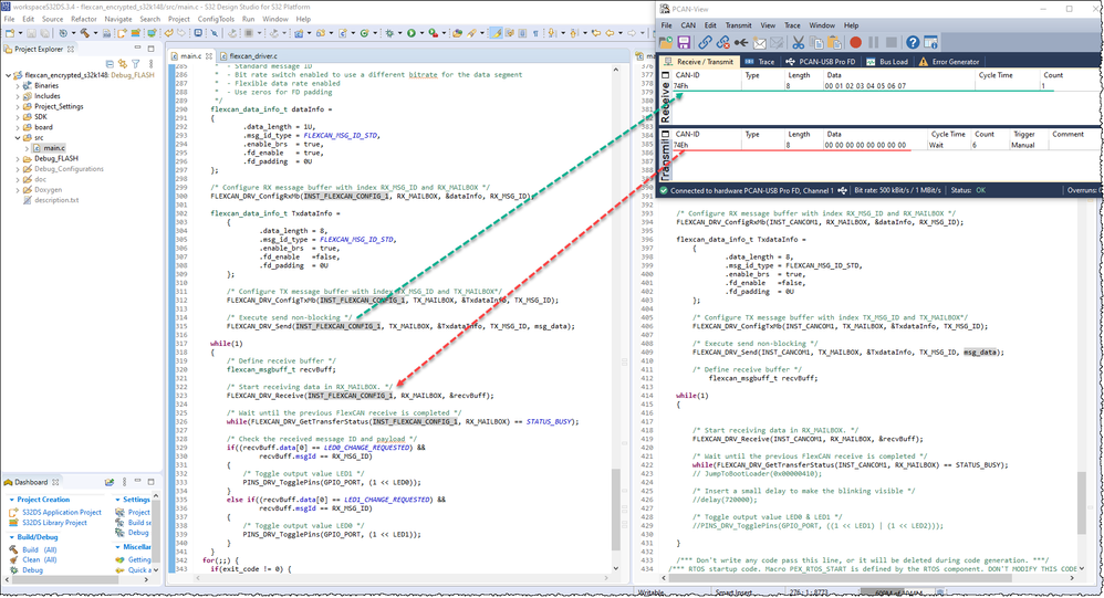

Robin_Shen
When I send CAN data from PCAN, the S32K148EVB is able to toggle LED.(Did you send the data with ID: 74Eh ?)

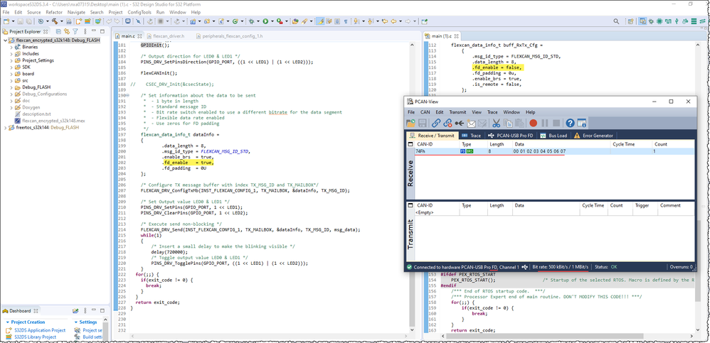

Robin_Shen
Sorry for the delay!
Would you please check if r-pi terminal is corrected configured? I modified the flexcan_encrypted_s32k144 as you shown me in main.
The LEDs is able to toggle.(Check the received message ID toggle LED after FLEXCAN_DRV_Receive )
