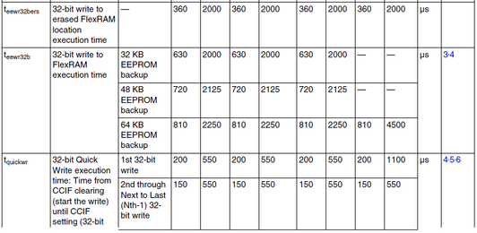

You need to wait until the previous 32b write is complete which is indicated by the CCIF flag.
The execution time is specified in the datasheet, rev.13.
Table 35. Flash command timing specifications for S32K14x series
A write function will have some overhead and this depends on the CPU clock frequency mainly.
The partition configuration is stored in the Flash IFR which is not accessible.
However, the DEPART value is loaded during the reset sequence to the SIM_FCFG1[DEPART] register.

Also is their any comment on time consumption of flash driver write function, here I see almost 3.2ms for 100 bytes of data writing.
8,830 Views
danielmartynek
As I mentioned, the execution time is specified in the datasheet, this is the time during which CCIF reads 0.
Then there is some CPU overhead of the driver that is not specified.
BR, Daniel
