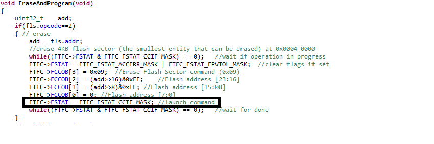

Hi @all experts,
I am working CAN Based Bootloader for S32k142.I am Facing issue for Erase Application  memory  from 0x5000 to 0x3FFFF.when I was debugging step by step I will be Successfully Erasing memory. When  I was Flash and run code it is immediately going to HardFault_Handler.if any having any idea please explore here  .
Debugging mode: Successfully Erasing memory
Run Mode: HardFault_Handler
Thank you for your Support

nelson_scheja
I had a very similar problem once (crash at flash operation in Run mode, but working fine on debugging). For me, it was solved by putting the function that starts the flash command into RAM and executing it from there.
If you are absolutely sure that your function EraseAndProgram() runs in RAM, I got no more idea about this.

davidtosenovjan
OK.
Do you execute this function from RAM?

davidtosenovjan
Easiest way it is just execute Debug_RAM target (if S32DS used), if runs the code from SRAM. Or you create new memory segment/section in the linker file and use an attribute before C function declaration to relocated selected function to RAM
__attribute__ ((section(".MyRamCode"))) // place the code below into .MyRamCode section
void EraseAndProgram(void);

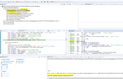

ganeshvaka2
Hello @davidtosenovjan
we are facing issue with s32k116 ,while trying to erase memory from RAM using API: EraseAndProgram .
Programming terminated with SIGINT Interrupt
Please find the attached Debugging Console Screenshot
Please find flash.ld file
Thank you

davidtosenovjan
What is value of 'add' at that moment? Could you check in assembler window if code runs for SRAM to be completely sure?
