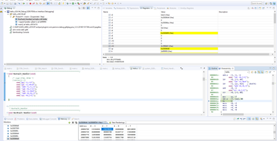

hajianik
Senior Contributor I
Hi Daniel,
Thank you for all your help on this.
Sorry for the delay, I was doing other tasks.
 I tried the code from the app note you send me to return to the instruction following the fault.
yes It does save the return address (PC)  on the stack WITH AN OFFSET OF 0X18 from the stack top
However from the screen shot , we van see that it is going to jump to where the link register is(0xffffffff9)
This will not recover the code.
I believe the ARM processor use the LINK and not the PC register for their return destination, You'd know better than I and correct me.
Sorry for dragging this too,too long time.
Thanks as always,
Koorosh Hajiani

danielmartynek
Hi @hajianik,
Please refer to B1.5.8 Exception return behavior
in ARM®v7-M Architecture Reference Manual
Normally, the execution returns to the PC address stacked (after asm("bx lr"), which is the address of the fault instruction.
The code from the AN modifies the stacked PC address by adding 0x4 offset to it.
I just tested it in the test project attached.
The SP is decremented further by 0x4 when the ASM code modifies the stacked PC address.
So, in order to return to the next instruction after the fault instruction, use this code instead:
void BusFault_Handler(void)
	__asm("mov r1, r13");
	__asm("ldr r2, =0x1C");
	__asm("add r3, r1, r2");
	__asm("ldr r0, [r3]");
	__asm("ldr r2, =0x4");
	__asm("add r0, r0, r2");
	__asm("str r0, [r3]");
BR, Daniel
