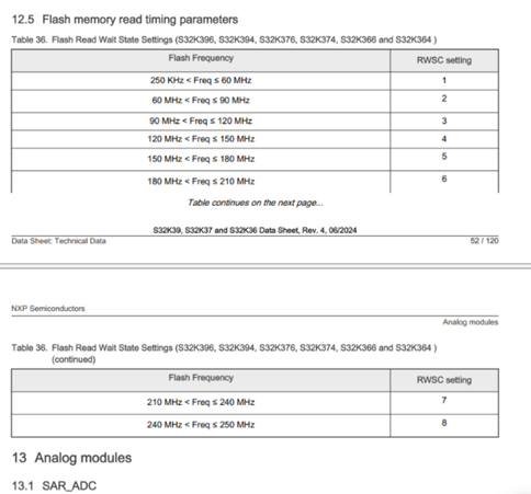

I did not configure the Flash by hand but it seems the configuration tool (or the example startup code) had set it wait states to 5 (which seems to match the 160MHz CORE_CLK), although it did not enable prefetching. I suppose this is a bit critical for my code, as disabling prefetching in the MPC5777C caused a 100us increase in its execution time.

- Given the 5 wait states of the Flash (vs. 3 of the MPC5777C when its peripheral clock runs at 132MHz or even 150MHz), is it correct to assume the MPC5777C Flash memory performs better than the S32K396 one?
  • MPC5777C:
    • Based on Power Architecture, with dual e200z7 cores.
    • Has a more advanced Flash controller with better pipelining and prefetch capabilities.
    • Often used in high-performance automotive and industrial applications.
  • S32K396:
    • Based on Arm Cortex-M7, optimized for flexibility and integration.
    • Flash controller is simpler, and performance is more sensitive to wait states and cache configuration.
