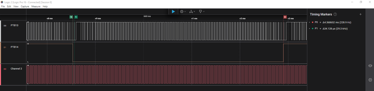

Hi Senlent,
Thanks for your help. However, the DMA doesn't seem to work properly. The first element of the buffer is written in the B register of the eMIOS channel but the source address is not incremented and I get an interrupt twice within the PWM period while I should get one every 128 PWM period (the minor loop size is set to 256 for a 2 bytes transfer). To see that, I've added a pin toggle in the DMA ISR function.
Here is a screenshot of the TCD registers and eMIOS settings:
And here is a screenshot of the oscilloscope:
As you can see, I get two interrupts within a few microseconds when I should get only one every 0.00436907 seconds (1 / 29296.875 KHz (PWM frenquency) * 128).
Do you have any idea why?
Hugo

Hi Senlent,
Thank you for your answer. However, that doesn't do what it should. I should get an interrupt when minor loop has done all its DMA transfers, which is set to 128 (at major loop iteration). Therefore, with a PWM period of (1 / 29296.875 KHz) * 128 transfers = 4.369067 ms. I can see on your screenshot that the period is ~3.413 us.
Also, the DMA is not reading from the buffer, only the first element is read and played. I don't see the TCDx_SADDR being incremented. Any idea why?
Hugo
5,715 次查看
Senlent
Hi@h_bouchard
I don't know why you want to do this, I changed your configuration according to your idea
And I added a PWM output as a reference comparison

5,645 次查看
h_bouchard
Hi Senlent,
After some tests, I figured that the ISR is called only when both buffers are played (every ~8.72 ms) on my side unlike on your oscilloscope screenshot. It seems normal to me because the "Enable Major Interrupt" check box is not set for scatter/gather channel 0. When I set it, it now works fine and the buffer is played properly. Here is the modification I made for scatter/gather configuration on both channels:
I've attached the final version of my test application if someone needs to do the same thing.
Thanks a lot for your help!!! It is really appreciated!
Hugo
