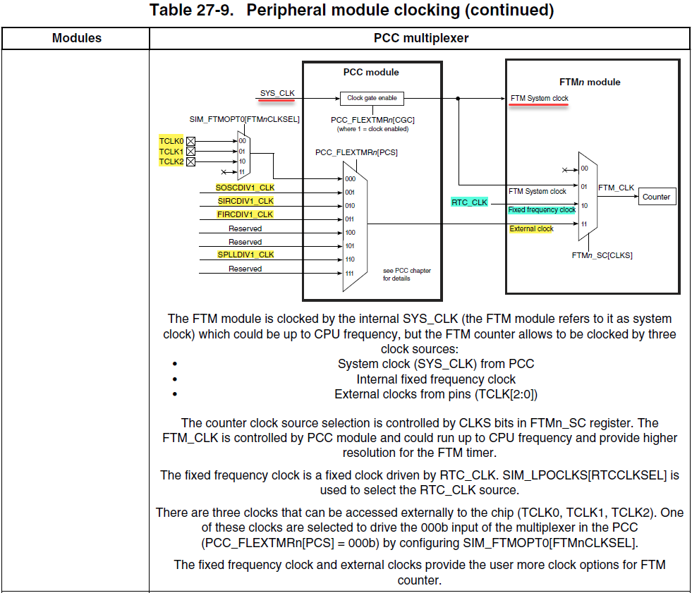

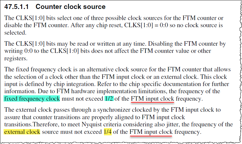

Hi JeorgeB,
According to the description of "47.5.1.1 Counter clock source" and "Table 27-9. Peripheral module clocking":
The frequency of the fixed frequency clock(RTC_CLK) must not exceed 1/2 of the FTM input clock frequency(FTM System clock SYS_CLK)..
The frequency of the external clock source(TCLK0 \ TCLK1 \ TCLK2 \ SOSCDIV1_CLK \ SIRCDIV1_CLK \ FIRCDIV1_CLK \ SPLLDIV1_CLK) must not exceed 1/4 of the FTM input clock frequency(FTM System clock SYS_CLK).
Table 27-9. Peripheral module clocking.pngTable 27-9. Peripheral module clocking.png
Due to: SYS_CLK = CORE_CLK = 80MHz
So:
Frequency of external clock source should not exceed 20MHz.
Frequency of fixed clock source should not exceed 40MHz.
But it seems to conflict with your test results. Would you please attached your test project? So that I can test it faster.
Robin

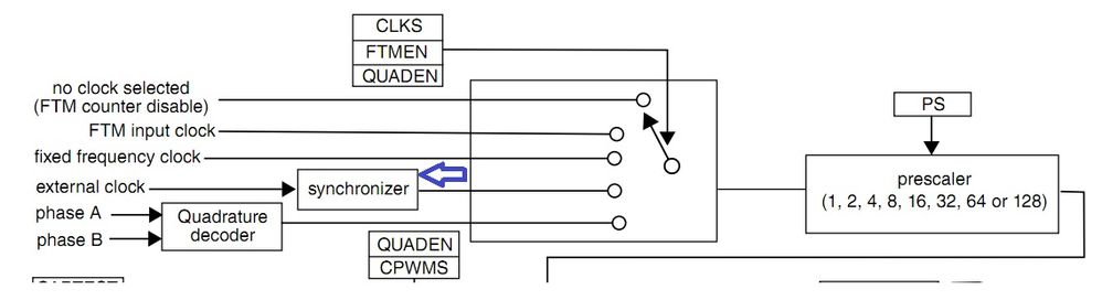

meanwhile reading RM, I see 2 points:
1. as you can see in below image, there is a synchronizer block between External clocks (which can include FIRC_DIV_1, SIR_DIV_1, SPLL_DIV_1 or TCLK[0:1]) and the FTM input. Unfortunately additional explanation about this block is not available and maybe this block is cause of the my question in first post.
Has anybody any idea?

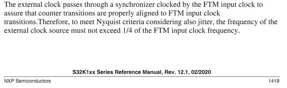

2. In continue, there is one paragraph about this block which is vague also:
what is purpose of these details about FTM?
Thanks.
