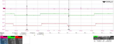

Hello @danielmartynek ,
I figured out my problem.
So the signals on the scope are not the FTM PWM outputs.  My HW is configured such that FTM n Ch's go through a quad input AND gate, and FTM n+1 Ch's go through a quad input NAND gate.
Looking at the differences between Figures 47-75 and 47-76, it seems the dead time is inserted on the rising edge only.
Since we are in complementary mode, the FTM Ch 3 is actually rising at 38.75, but the NAND gate is showing it as a falling edge.
Sorry for the confusion.

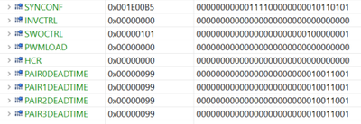

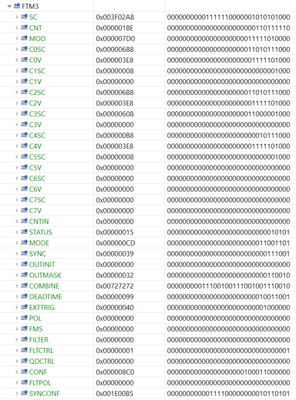

To give more detail, I have FTM3 running at 80MHz with Center Aligned PWM mode enabled.  The MOD value is set to 0x7D0, which gets me time period of 50us.

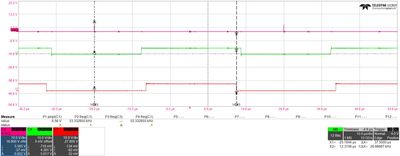

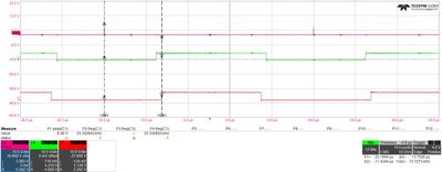

I took some screenshots to show you exactly what I am seeing.  For this example, I am setting the PWM for 50% duty cycle, and I have a deadtime of 1.25us.  I am scoping FTM3 Channels 2 and 3 which have COMP1, DTEN1, SYNCEN1, and FAULTEN1 all set to 1 in the COMBINE register.  I have INITRIGS coming out at CNT = 0.  The Pink channel on top is the INITRIG, the middle Green channel is the FTM3 Ch 3, and the bottom red channel is the FTM3 Ch 2 on the scope.
What I would expect is that both PWM channels would rise at 13.75us from the INITRIG, but as you can see below, on FTM3 Ch 3 sets at 12.5us, while Ch 2 sets at 13.75us:
I would have also expected both channels to clear at 37.5us.  However, FTM3 Ch 2 clears at 37.5us, and FTM3 Ch 3 clears at 38.75us:
Looking at the POL register shows that they're all 0 at the time of the capture.  Why is that the Ch 2 has the deadtime inserted at the rising edge, and Ch 3 has the deadtime inserted at the falling edge?
Ultimately what I am trying to do is have some deadtime asserted between the FTM3 Ch2 and Ch3 such that they are both center aligned, but Ch 3 sets 1.25us before Ch 2, and clears 1.25us after Ch 2.
