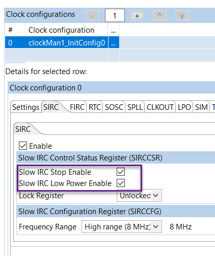

The clock source of LPTMR is currently set to SIRC. It is found that if SOSC is turned off, LPTMR cannot wake up from VLPS mode. Below picture is the setting of clock.

SOSC has no impact on the LPTMR functionality in VLPS.
The SOSC clock must be disabled before the MCU enters VLPS anyway.
The power manager SDK driver disabled SPLL, SOSC and FIRC and switches to SIRC when the POWER_SYS_SetMode(VLPS, ...) function is called.
Is the SIRC clock enabled in VLPS
