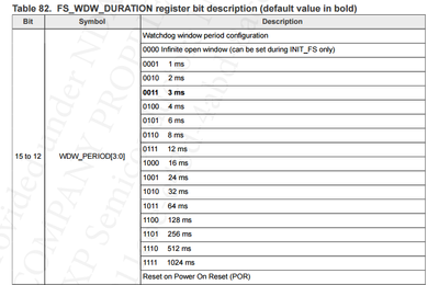

guoweisun
On the fly to change the WD, you have to change it by below WDW_PERIOD[3:0]bits in the FS_WDW_DURATION register, you can try it.
The duration of the watchdog window is configurable from 1.0 ms to 1024 ms with the WDW_PERIOD[3:0] SPI bits.
The new watchdog window is effective after the next watchdog refresh.

1,319 Views
guoweisun

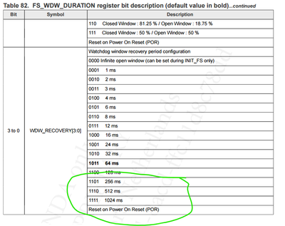

1,326 Views
guoweisun
Here I only support FS26 and don't know too much about bootloader.
Do you mean to change the WD duration into longer time as below showed?
