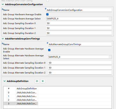

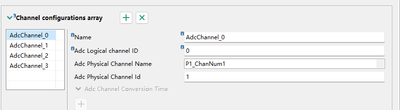

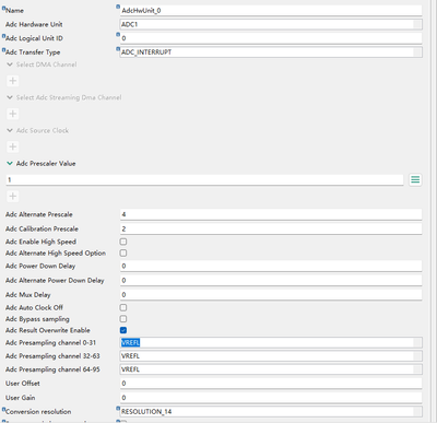

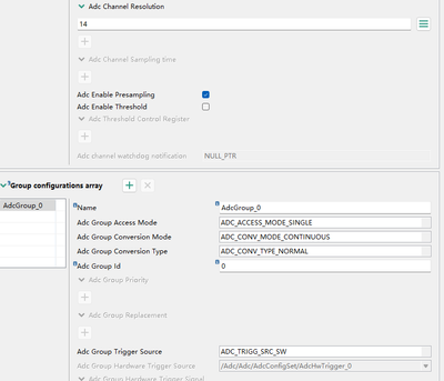

danielmartynek
Hi @WeiC,
Have you measured the ADC input voltage on the pin?
What is the FREF voltage?
Can you share the ADC configuration like sample time, frequently, resolution, ...?
Thank you,
2,924 Views
WeiC
input volt is about 1.007V,ADC clock is from FIRC.
WeiC_0-1700527900213.pngWeiC_1-1700527918760.pngWeiC_2-1700527939499.pngWeiC_3-1700527956849.png
