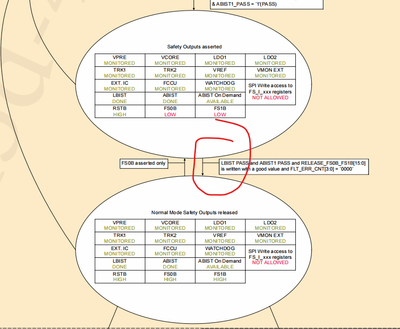

pagdav
The SBC should be in the status "Safety Outputs asserted" (Figure 14 - Simplified functional state diagram).
6,920件の閲覧回数
guoweisun
Seems in that state can't enter normal mode by CAN message

pagdav
Dear @guoweisun,
my request is:
I would like to switch manually from "Safety Outputs asserted" state to "Fail-Safe normal state" state using the function Sbc_fs26_ReleaseSequence().
In the actual RTD driver, the switch from "Safety Outputs asserted" state to "Fail-Safe normal state" state is automatic at the end of start-up.

guoweisun
You should refer to below flow chart whatever manually or automatically enter into normal mode from the Safety Outputs asserted state.

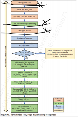

guoweisun
If I understand your questions correctly, you don't need enter into debug mode and exist into debug mode.
You can see below flow chart of SBC,if you don't use emulation mode,you can skip this and after release RSTB directly enter into INIT mode.
