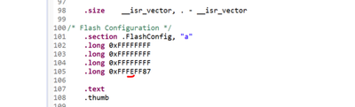

I went through the start-up code. If we change the value from FE to FD is flash will secure?
Can we do that if I want to change this configuration in run time?

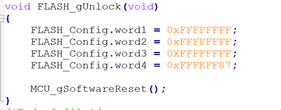

I tried the following
When any request comes from an external environment I am calling this function to unlock the FLASH but when control comes here it is going to default to ISR. Is it the right way to do that?
If not how we can lock and unlock FLASH in RUN time?

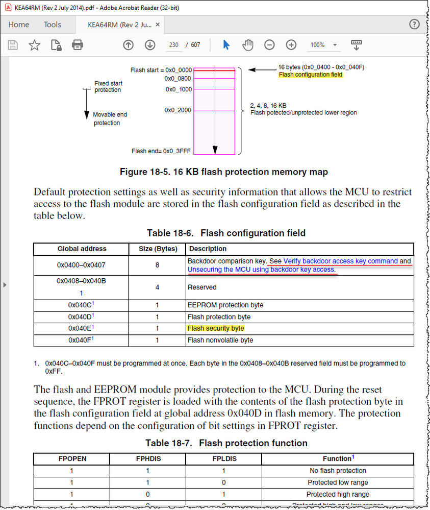

Please read 18.3.6 Protection of KEA64RM. If you change the value of Flash Configuration from FE to FD, the flash will secure. 0x40E is the address of Flash security byte. FTMRH_FSEC[SEC]=01 mean Secured. Refer to 18.4.2 Flash Security Register (FTMRH_FSEC).18.3.6 Protection KEA64RM.png18.3.6 Protection KEA64RM.png
Recommended you refer to 18.3.7.1 Unsecuring the MCU using backdoor key access after you got the request over LIN or any other external request.
