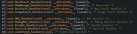

Context
When creating a new project in S32 Design Studio for the S32K344 platform, a folder named Project_Settings/Startup_Code is generated, with the following files
In the file exceptions.c file, there are Fault Handlers defined
And although there's a small explanation in this link for the S32K14 in this page for the first 4 functions, I could not find anything for the bottom 5.
Question:
Perhaps this is a lack of knowledge on our end, but
- Could I get pointed in the right direction for the contents of this file? Or could someone explain what these handlers do?
- How can I find what the reason is for things like the HardFault_Handler? As it can get triggered by a lot of reasons, I'd like to find why my program got here, as well as whether the fault bit remains set after a functional reset?
Thanks in advance for your time and help!

Hi @MateoSegura413,
  • All the handler functions there are weakly defined and can be redefined in you custom code or by drivers that you use.
  • The first four handlers are fault exceptions handlers and I believe is it well enough explained in the document you linked to this thread.
  • If you get a HardFault, please debug it as shown in the document. Although the K3 series has CM7 core not CM4, it is the same.
  • The last handler (undefined) is used in place of unused interrupt handlers (to detect spurious interrupt).
  • NMI (non-maskable interrupt) is exampled in the S32K3 RM rev.4. For example, Section 46.4.1.
  • For more information about the resets of the handler, refer to ARM documentation like the ARM Cortex-M7 Processor Technical Reference Manual (https://developer.arm.com/documentation/ddi0489/b/) or search it on the internet.
