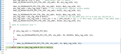

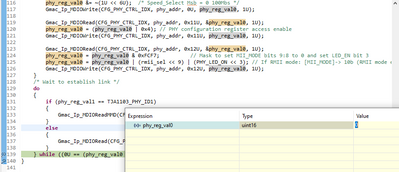

Dear Expert,
We bought S32K3X4EVB-T172 Evaluation Board for development. (S32K3X4EVB-T172 Evaluation Board for Automotive General Purpose | NXP Semiconductors)
We are currently having problems initializing the TJA1103 transceiver. We have downloaded and installed the TCPIP stack (refer: https://www.nxp.com/webapp/swlicensing/sso/downloadSoftware.sp?catid=SW32K3-REFSW-D ) and the source code includes the Init for the TJA1103 transceiver.
But when we tried it, the code didn't work. And here is the image for the core when we debug.
Could you please help us to feedback about these cases?

which kind of tcpip version do you use? A tcpip stack 1.0.3 supports T172 board as per its release note
BR, Petr
