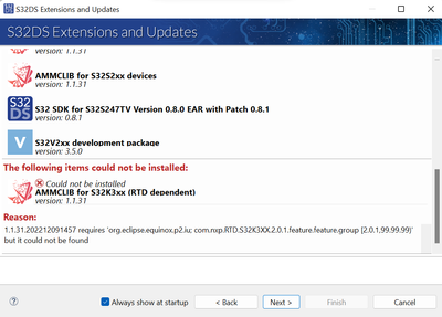

While installing the extensions in S32 design studio, I got the below mentioned error.
Kindly  some give the solution for this.

as the Reason indicates, this AMMCLIB version requires to have RTD.S32K3XX.2.0.1 version installed.
So download it from https://www.nxp.com/webapp/swlicensing/sso/downloadSoftware.sp?catid=SW32K3-STDSW-D and follow steps given in https://www.nxp.com/document/guide/getting-started-with-the-real-time-drivers-rtd:GS-AUTOMOTIVE-RTD to install this RTD.
