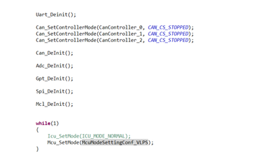

my project is based on MCAL 4.4 RTD 1.0.0 of S32k146 with FreeRTOS, before I try to sleep, I deinit all the modules except ICU and then use Mcu_SetMode(McuModeSettingConf_VLPS) to make mcu sleep.
it seems that the mcu is into VLPS which I could not debug via PE, but it could not wake up either.
Is there any step I missed or configuration I configed wrong?

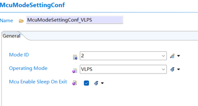

ans: MCU should not enter the sleep-on-exit ? but the RM said it should be, and i do configured that "sleep-on-exit" in MCU as below.

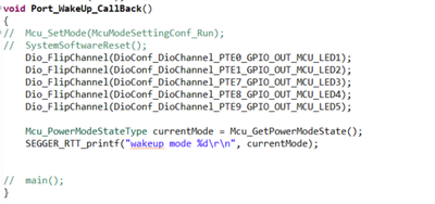

I find that after the set_McuMode(vlps), I set the PortB0 low, the PORT_CI_ICU_IP_B_EXT_IRQ_ISR works and it could turn on the light as well as the mcu mode is run. But I do not know how to make the program re_init all the modules. Or should I reset the mcu manually?

danielmartynek
Hi @KILLERzheng,
Thank you for all the information.
I think the issue is in the Sleep-on-exit mode.
If the mode is enabled, the MCU goes to VLPS again after the ISR is complete.
Please try with the mode disabled.
Also, to get lower consumption, disconnect the debugger and power-cycle the MCU.
