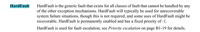

a) I Don't find the point on manual that describes this behavior (Hard fault), can you tell me where is?
This is described in core reference manual:
b) This hard fault exception happens also with multibit ECC errors at runtime? Par 20.5 above talks about FCCU or ERM interrupt response and NOT of a hard fault exception (due to a precise error on bus fault.) If yes how can it be compliant with a FCCU reaction. How should manage it ?
It be triggered on multibit ECC. I also expect you have some other cause for hard fault. Like reset escalation due to ECC. Make sure that you execute the ECC error injeciton only once and stop after reset. To prevent cyclic behavior.
