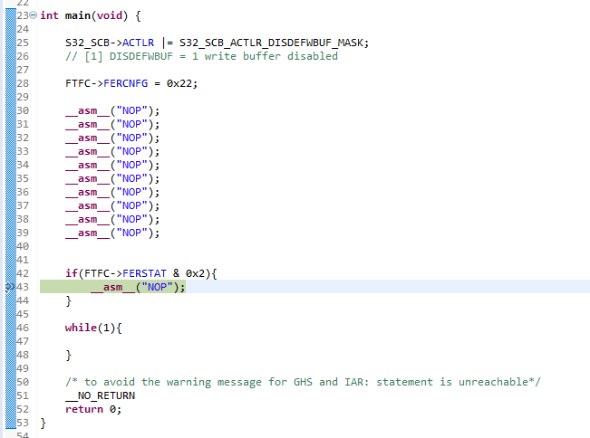

After I set the FDFD flag, i am polling for the bit DFDIF in FERSTAT and it never set.
Am i missing something ?
2,235 Views
danielmartynek
Hello @krishnasmartbytestech,
I don't have access to the S32K148 EVB right now, unfortunately.
But I tested in on other S32K1xx parts and it works as expected.
Can you test it with this simple code?
