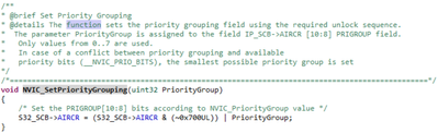

In addition, about priority grouping, a function is also provided, see the following image.
