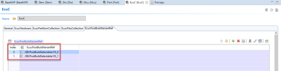

Have configured 2 "SelectablePostBuildVariant" using EcuC and only for Port module the "Post Build variant" is ticked, not for other modules. On generation, all other modules also are getting generated for both variants though "Post Build variant" is not  ticked, the content is same just different names according to variant.

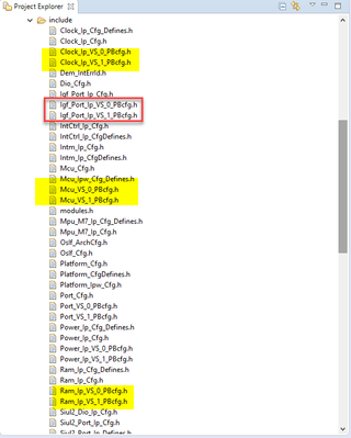

With Post build variant, you need to add pointer of your Module config when call Init() function (Ex: Port_Init(&Port_VS_0_PBcfg). So, in your Init module step, you need to put which module config set you want to use. These files are generated depending on your variant references:

For e.g. even though I have not ticked the postbuild checkbox in MCU module, it still generates Mcu_VS_0_PBcfg.h and Mcu_VS_1_PBCfg.h. So even though I want Mcu to be a pre-compile variant and do not want to send any specific parameter to Mcu_Init, I have to send one of the config structure as argument, as the files are generated accordingly. Same is the case for all the other modules.
Sure there are workarounds to get it working somehow, like create 2 separate projects, one for pre-compile modules and another one just for port module with post build only of port module or another option is let tresos generate for all modules both variants and during compilation select only one for, e.g. compile only Mcu_VS_0_*.* .

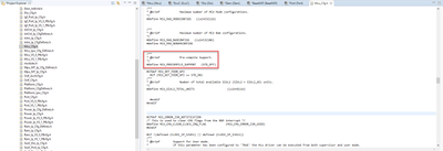

I believe as long as you have PostBuild variants, the PostBuild configuration files (VS_0, VS_1) will generate. The only difference when ticking Post Build variant used is the following line in McuCfg:

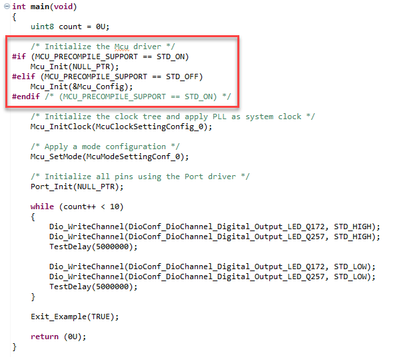

You can check for precompile support when initializing your application as in the RTD examples:
